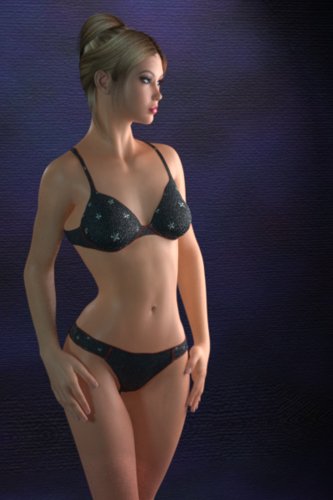

JonstarkJonstark Posts: 2,738
I picked up Luxus for Carrara in the PA sale (along with many many other things - ouch, my bank account is not thanking me...)
I've picked through the other Lux threads, and there's plenty there about skin settings for Reality, Luxrender, and Luxus for Studio, but not much at all about Luxus for Carrara.
So I've started experimenting, and I feel like I'm making progress, but because most of the other tips and tricks for skin settings on those other forums don't seem to apply much to Luxus for Carrara, I feel like I'm figuring things out on the fly.
So here's what I've got so far (see the attached render to decide if I'm even on the right track or not, all advice welcome):
Top Shader: Lux Surface
Material: Lux Glossy Translucent
Diffuse; Texture map of my V4/M4/V5/M5, whatever, but with the brightness taken down to 95%
Transmission: Same Texture map as in the Diffuse, but with the brightness at 100%
Specular: I left this alone, with a color of R 51, G 51, B 51
Index of Refraction: 1.44%
Roughness U: 22 %
Roughness V: 22%
Absorption: Color and made it a Red R 187, G 4, B 9
Depth: .5%
Bumpmap: A multiply operator with my texture bumpmap for the V4/M4 in the first field and a 1-100% in the second field, set at 2%
Interior: None
Exterior: None
Area Light: None
All the skin areas have the same setup, only the texture map changes (arms in the arm section, torso in the torso section, etc).
Lips are done exactly the same, except the Roughness U and Roughness V are set to 2%
I haven't even begun to touch the eye surfaces yet, as I'm just focusing on the skin settings at the moment. Oh, and I used Philw's portrait studio Window Right setup scene, so it's an enclosed box with main lightsource from the right, a fill light from the left, and rimlights from left and right, as well as a spotlight focused just on the backdrop. I also used a Lux Cloth shader for the bikini, but it looks weird and rough, and looked better just when I left them as regular Carrara shaders and Luxus changed them, so I'm not sure that's the way to go.
Anyway, I just wanted to throw this out there to see if anyone has an insights that may help or uses any drastically different settings.

  • booksbydavidbooksbydavid Posts: 429
    Thanks for this. I have Luxus but haven't done much with it because I just couldn't get skin and hair to look good. I've been pretty busy, so experimenting has been down to a minimum. This looks like a good start. I will be making time to try this out.
    Thanks again.
    edited October 2013
    I see you solved the issue with her legs...
    I need to have a play with skin in Lux... How does the specular channel work? Can it accept a spec map?
    (I haven't loaded it yet on my new Mac running C8.5... Hoping there is an update very soon - that's why I don't just check myself... :/)

  • JonstarkJonstark Posts: 2,738
    edited October 2013
    Thanks booksbydavid, I'm hoping a few interested Luxus users can put their heads together to puzzle out some acceptable settings, as the settings that they refer to in the tips and tricks for the Reality and Luxus for Studio threads just don't give the same results in Carrara (probably because Luxus for Carrara has different controls, and is converting from a different rendering app and at a different scale I'm guessing). I've sort of gone a bit through this before, trying to figure out skin settings for TheaRender, and since they are both unbiased renderers I was hoping that there might be some similarities in settings, but unfortunately all the controls and gizmos look different and foreign :)
    Well not so much solved, as just erased all settings and started again. I have no idea why the first time I got such strange results on the legs, I'm just chalking it up to an error/bug that popped up the first time I was adjusting shaders :) Hopefully it won't reappear, or if it does, at least I'll spot what's going on.
    Specular channel can certainly accept a spec map, no problem there, but (as I found out in Thea too) I mostly prefer to use an even reflection (thus the straight color I left in the spec channel) for the skin, and use the spec map as a very light add-on to make it appear the skin is more reflective in little places that make sense. I hadn't gotten as far as trying to add the spec map to the spec color, but I don't see any reason why a standard Carrara add modifier wouldn't work just fine.
    I did see the post from Spheric Labs about the fact an update has been submitted to DAZ and so hopefully we'll see it soon... but not like 8.5 'soon' though... :)
    Post edited by Jonstark on
  • DartanbeckDartanbeck Posts: 21,747
    Wow. Gorgeous render, jon!
    I bought it right away, just because I liked how passionate about making it and tweaking it to the users liking thet author was (is). I look forward to using it - but, alas... still have my own pile of things to get done first. Where did you say that you saw "Time" for sale? Is it ever on. like... 99% off sale?
    I had a play with Jon's settings last night. I quite like how skin renders with these settings. I'm still playing with the eyes. It seems to be more difficult to control the specular size using luxus materials. I'm still working on it.
