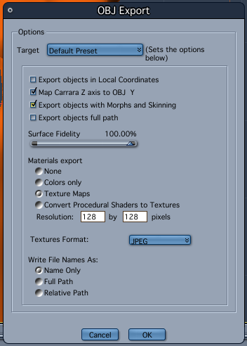

Trying to export a DAZ figure (V3) as OBJ with skinning and morphs, but generic V3 is all that I get.
I have tried selecting the Animation Group and also just the model. Both times I check skinning and morphs but no cigar.
What am I doing wrong?

    you're quite right. OBJ cannot hold additional morph shapes, it's just a model format.
    "Export with Morphs and skinning",.. should export the selected figure in it's "Current pose" or deformed state.
    So it's kind of a "Snapshot" of your figure in it's pose.
    What it doesn't do is export all of the different shaping morphs contained in a figure, ...or anything to do with the skinning or rigging of the figure.
    It doesn't create a skeleton, or export the morph parameters,.. which is what the option name suggests.
    It simply exports the current mesh, in it's current pose, rather than the default (T-Pose)

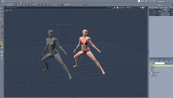

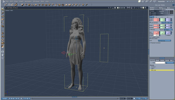

    HI Holly,. :)
    It's working for me on PC with V3,(pic 1)
    but I'm seeing some issues with Genesis2 with hair and clothes, exported as OBJ (see pic 2)

    3DAGE said:
    HI Holly,. :)
    Thank you! Looks Like Genesis is posed but the accessories are grouped in. I wonder if that would happen if you (say) selected the hip bone for export.... Fenric suggests this in an old thread (for an unrelated issue). I'm not familiar with all of Genesis' "fitting" abilities. I assume it's something about that...
