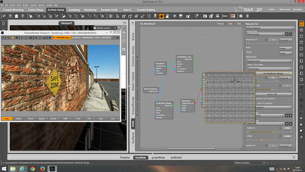

  • linvanchenelinvanchene Posts: 1,382
    edited April 2015
    Because I am a huge fan of all the creative designs of the artists your posts motivated me to check if I can replicate the mentioned issues.
    I am under the impression that most of those issues are not the "fault" of the artists but they exist because in the past the artists did not have many alternatives to work around the issues you mentioned.
    My motivation of this post is to illustrate on this practical example how "new" render engines like Iray and OctaneRender now offer new opportunites to solve some of those issues the OP mentioned.
    marble said:
    The main problem is there are bits of geometry which are not selectable in the scene and which slow down the render to snail's pace.
    I tried the scene in the OctaneRender for DAZ Studio plugin and there it rendered very fast. After about 30 seconds even at 3840x2160 resolution the noise cleared up in the highest quality PMC mode.
    In OctaneRender when you hoover with your mouse over the live viewport all the surfaces names appear in a pop up window.
    With the OcDS surface selection tool you can click on any surface in the live viewport to open it in the materials tab or the Node Graph Editor.
    With another click of a button you could simply hide the surface or the object that slows your scene down EVEN when the object is part of a group and cannot be clicked individually in the DAZ scene tab.
    marble said:
    One more point about this product. While it looks very realistic from a distance, it really needs a displacement or a normal map for the brickwork. The edges of the walls, etc., are razor sharp.
    I had a look at the provided bump map and the issue seems to be that the map covers to large of an area.
    You may be able to spot in the screenshot that the bulldog logo is also part of the mainbrick wall texture.
    It seems for the all walls one 4000x4000 texture was used.
    While in theory this sounds large in practice it does not allow for any close ups.
    Please keep in mind that more and more users will start to be working with UHD monitors and images will be looked at 3840x2160 resolutions..

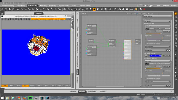

    Mixing Maps and logos
    What to do with the bulldog logo?
    With 3Delight there was only the layered image editor.
    With OctaneRender and proabably also Iray artists will now have more creative options how to combine textures with the help of nodes.
    In this example a tileable wall texture could be combined with a separate map with the bulldog logo.
    Compare example screenshot:
    A mix texture node was used to combine the background blue pane with a tiger logo.
    A displacement node could be added to the resulting material to displace both the logo and the background pane equaly.
    IF different displacement values should be used for the background and the logo then a "mix material node" can be used with separate displacment values for each part of the "mixed" surface.
    I seem to remember that displacement maps can be created by desaturating the texture in Photoshop and applying the B&W image into the displacement channel. Is that correct?
    I do some map compositing in photoshop when the artists did only provide bump maps and did not provide any displacement maps.
    The issue is that this will not be very precise.
    Side Note:
    The idea of creating displacement maps is that the original modeling application (like zbrush) creates an accurate map of all the detail that is available at higher subdivision levels.
    Accurate means that if an area is displaced by 2cm or 4mm the same displacement happens when you apply the map in another 3rd party application.
    At the same time you can also render out the bump or displacement maps.
    The user then has the choice to
    - use normal or bump maps if the object is in the background
    - use the displacement maps if the object is visible in the foreground and the details matter.
    Alternatively as an unprecise workaround for some cases you can also connect the bump map to the displacement slot in your render engine.
    Adjust the Offset properly so displaced areas do not intersect with other objects.
    In the example screenshot you can see how some displaced bricks still intersect with the sign.
    Of course you can also add a displacement offset value to the sign to compensate.
    In this case this may not work as intended because the sign is on the same map as other objects.
