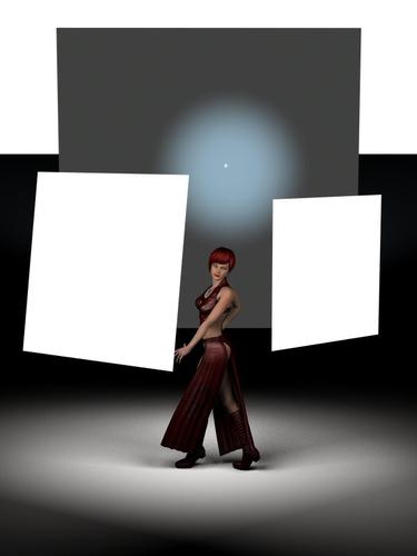

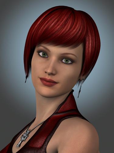

I have some experience in photography and I know that studio photographers usually use soft-boxes or umbrellas for portrait lighting. They give soft light without harsh shadows that still looks very 3 dimensional and is flattering for portraits.
I found commercial products that added mesh lights that would simulate soft-boxes, like for example http://www.daz3d.com/shop/inaneglorys-photo-studio-3
That product looks very nice with lights to simulate beauty dishes as well as soft-boxes, but then I discovered that Daz Studio includes an UberArea light. There are presets to add area lights of various shapes, the plane and the disc being most useful for simulating a soft box. There has been a lot of discussion about portrait lighting, for example here http://www.daz3d.com/forums/discussion/1201/, but I could not find any reference to using UberArea lights to get soft-box like lighting.
Now the UberArea lights are a little weird. They are actually light emitting shaders on a surface, so you have to control them from the surface tab rather than as a light. There is some documentation on them here: http://www.omnifreaker.com/index.php?title=UberAreaLight
I decided to try to test this with a simple portrait lighting setup. The images below show the resulting render and a setup picture to show you how the area lights were placed. In studio lighting you usually place the lights 3-6 ft from the subject. You want the soft-box to look large to the model. If you place the soft-box far away, you will get hard lighting (sharply defined shadows).
For this picture I have a primitive plane set vertically well behind the model as a backdrop. The primitive plane is grey and is emitting ambient light so I don't need to light it. There is a light blue spot light near the back drop plane that is illuminating the light blue around the models head. The key light is camera left. I scaled this UberArea plane a little larger and the intensity is about 2x the intensity of the fill light which is camera right.. I used the UberArea light fall off feature so that the UberaArea lights do not illuminate the background. You can see the range of the UberArea light illumination on the black ground plane in the setup picture.
With the UberArea lights the "Samples" parameter controls the quality. The default value of 8 usually gives you noisy renders. The render below was done with samples set to 32 and the shading rate set to 0.2. It still may have some noise in the shadows. Render time was about 24 mins for 1600x1200.
I am pretty happy with the lighting and 3 dimensionality of this image. I'm surprised there has not been much discussion of this kind of lighting.

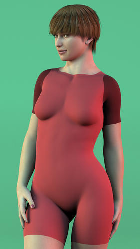

    I often use a setup more common for product visualisation: With the big area lights facing each other and another overhead mainly lighting the backdrop. (The cyclorama is just a quick hack in Hexagon.) Although its mostly aimed at creating even lighting, messing about with the light colour gets some interesting results.
    People are turning to other renderers before giving Uberenvironment a chance. Even with a single area light and setting UE to 'GI (bounce)' can give some good results, like the teapot below.

    I set up this test scene, you can decide for yourself if you need UE.
    300 x 400 - 87K
  • prixatprixat Posts: 1,595
    Here is the scene without and with UE:
    There are 3 main 'behaviours' that UE puts back.
    Most obvious is the Radiosity, light bouncing off everything. So much light I actually had to turn down the intensity of the Area Light to 80%.
    (It was on 200% with no UE.)
    Second and closely related is the Ambient Occlusion, where it realises that as angles of corners get tighter the less light gets into the creases and crevices.
    Thirdly, and probably the most computationally intensive is the Indirect Light Transfer. Its not just the brightness of the light that effects its surroundings its also the colour. The way the blue and red spheres are colouring the scene in their vicinity etc.
    These 3 together are Global Illumination (GI) but often people just switch on radiosity and call that GI.
