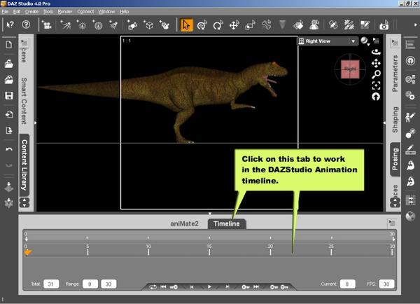

I have some good news I've mastered 1 step of the walk animation but for some strange reason when I start to move the 2nd leg and animate and replay it both legs seem to move at the same time at not when they are supose to. How did you do it on your cat animation without this issue?
Chears, Ian.
Without a movie or at least some screen shots of your setup, I cannot begin to guess what the problem might be.
for some reason it won't let my post a video clip it keeps sticking on the load section any chance you can send me your email address through a PM and I send it you that way be alot easier 4 me, chears.
You are having a problem because you are trying to do keyframe animation on the ANIBLOCK TIMELINE. You need to bring up your DAZStudio animation timeline and do your keyframing there. The aniblock timeline is only for working on the aniblocks.

Yes you can make an aniblock out of the daz timeline animation.
