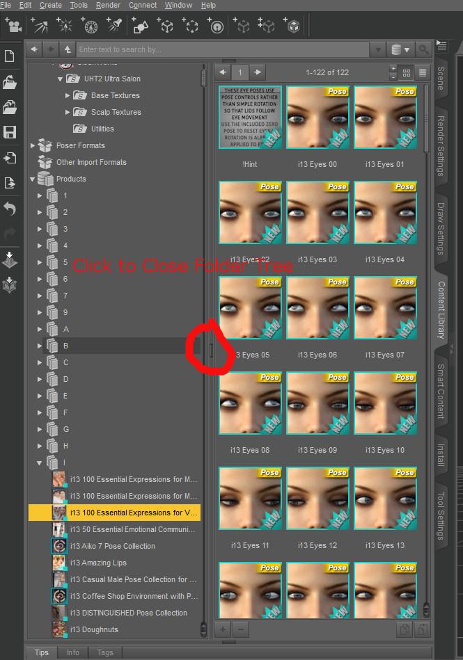

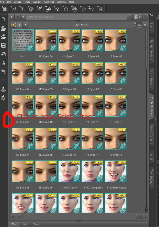

More than likely, you've accidentally closed that window. In the middle of the Content pane, off to the side, is a little bar. Clicking it opens and closes part of the pane. I've included screenshots. If this isn't your problem, please upload a screenshot with the problem you are having. Screenshots are always helpful in diagnosing problems. :)

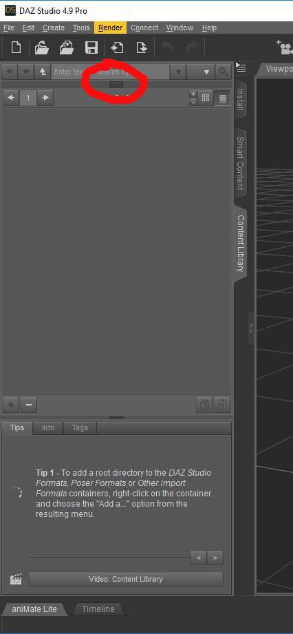

Accidentally closing the window sounds like something I would do. But, alas, here is a screenshot of my Daz program. There's nothing to the left to reopen the window. I removed the Content Library pane then readded it, and same--cannot seem to open the window.

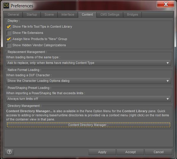

Ah, it looks like DS can't find your directory. If you click on Edit>Preferences under the main menu, that will bring up a dialog box with some tabs across the top.
Click on the tab that says Content. Down at the bottom, there is a button that says Content Directory Manager. Click on that and it will bring up another dialog box where you can tell DS where your content is if you installed via DIM.
If you plan to install just using Connect, then Login under the Connect option on the main menu and any content that you've purchased should show under the Install tab ready for download once you've logged in.
Thanks again, Knittingmommy. Not sure that's it, though. I followed your steps, but Daz already had the right folders selected. My search pane also works--it can find content. Just can't find the file folder view.

That's because it's at the top — look again directly below the search bar, you'll see a doubled-up tiny little button. Click on the lower one (I think) and your folder view will reappear. If that doesn't work, try the upper one.

Ah, SpottedKitty could be right. I didn't even see that. Try clicking here where I've circled on your screenshot.

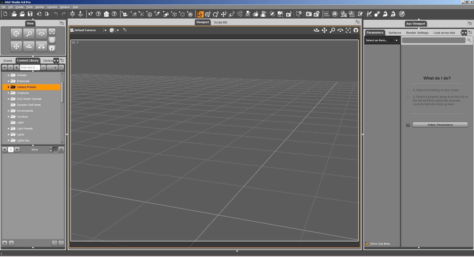

This is what my layout looks like:
