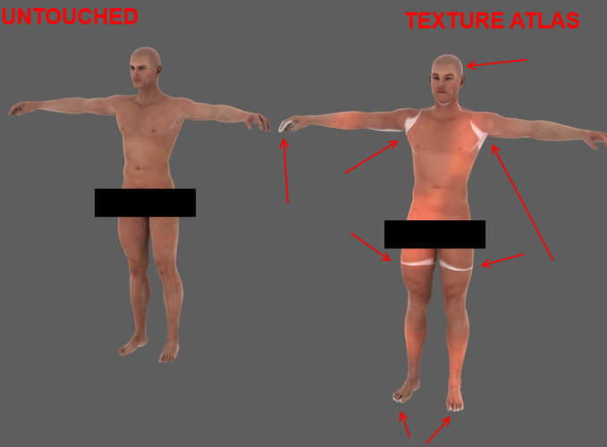

However, I then tried the texture atlas on a basic Victoria 5 figure: No clothing, no modification of any shape or form. The texture atlas still did a bad job and added some white lines. I did a search and saw a single post stating that the "texture atlas is still broken on genesis figures" and nothing more.
So I tried to do a test with a Victoria 4.2 figure, using the V4_LOD_4k resolution level that comes with Daz... And the textures broke again. I tried changing the weights and using 2048x2048 but the results were the exact same.
I can't get the Texture Atlas to work on anything, not even a basic Victoria 4.2 figure with the lower usable LOD... Am I doing something wrong, or is the Texture Atlas simply unusable in it's current state? I included before-after pictures to show what is happening. It'd be extremely thankful for any information you can offer: From the tests I ran, everything else worked perfectly (including an exported genesis + supersuit in motion), it looked very good and would it definitively solve my last asset issue.

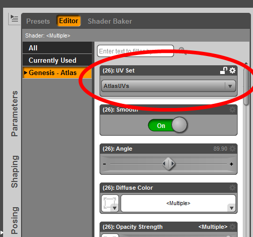

Regarding your problem, it looks as if you don't have the right UV set selected to go with your textures. There should've been an "AtlasUVs" UV set created. You need to make sure that's selected for every material zone on V4 on the surfaces tab.
Oops, sorry for the image size. Before posting I did do a quick search in the "New Forum TOS" thread and I didn't see an image size limit. My bad.
I just checked, and my UV set is actually already set to "AtlasUVs" for every part (I checked each item one by one). If I change it to "Default", I get a frankenmonster pretty much. Just to confirm I went to the right place: I select Victoria, click on "Surfaces (Color)" at the bottom left, click "Editor" on top left, select a body part on the left, and scroll down until near the end for the propery "UV Set" located between "Lighting Model" and "Smooth". If that was the right place, is there any other setting I can try that might help the situation?
Edit: I just read your thread and watched your video about UVs. While it was for 3.0 instead of 4.0/4.5, things are mostly similar and it does seem to point that I am using the AtlasUVs (except for the results anyway). If I use the Texture Atlas on a Base resolution Victoria 4 figure, it actually works flawlessly. The problem only happens if I use it on the 4k LOD one. I added a screenshot of my settings, alongside with the content of the texurtreAtlas folder (The typo is present in the offered default path). For reference sake, I did pick "Diffuse", "Opacity" and "Bump" as the only options, in TIFF format (Picking all the options will have no change in the result). If I change back the Resolution Level on the right to "Base" the image will look fine, but it's obviously not a valid option since I will be back with a 65k polygon Victoria figure instead of a 4k one.

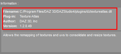

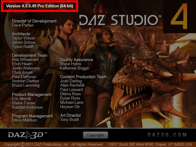

Running DAZ Studio 4.5.0.49 Pro Edition (64-bit) with Texture Atlas version 1.2.0.49.

Clicked 'Accept', suddenly got white lines. So I double checked the model UV set, confirmed it is using newly created 'AtlasUVs'.
