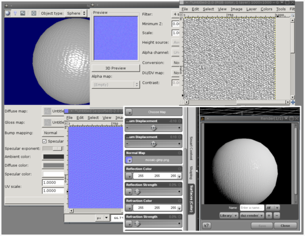

    Now here's a couple of other things...
    From left to right...
    Displacement map, set to 100% -1,1
    (ran displacement map through the normalmap filter in GIMP)
    Normal map, inverted X and Y
    Normal map
    It looks, at least with the GIMP generated ones, in order to be 'right' the X and Y need to be inverted. I don't have any 'baked' ones handy to test, but, if I recall correctly, the Blender baked ones had that same problem...
    1000 x 800 - 49K

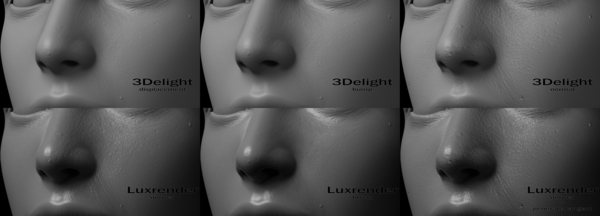

  • Midnight_storiesMidnight_stories Posts: 4,112
    I will admit in some cases it is better the first one is with out normals and 2n one is with normals baked in Zbrush
    859 x 918 - 258K
    859 x 918 - 228K
  • SickleYieldSickleYield Posts: 7,644
    Wow. That is a heckuva sculpt job.
