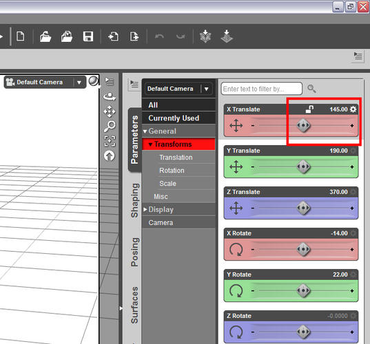

I quite often find that I set up a camera view as I want it, but then in another window (e.g. the pose window) I forget I have this view selected and move the camera by mistake, thinking it's the perspective view. Is there some way I can "protect" my camera position, zoom etc to prevent me accidentally changing it?
Thanks
When you have the camera selected; go to the parameters tab and click on the padlock icon in each of the translation & rotation parameters (you need to have your mouse over the parameter to see the icon).

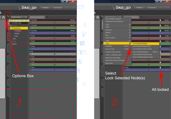

To lock every translation and rotate axis in one go try this. Click on the Options Box in the Parameters pane as shown below.
thanks both for that! Obvious, really..
Obvious; only when you know how and where. ;)
