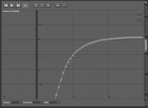

I find this easier to do visually using the graph editor in aniMate2. (or graphMate) This is exactly what Jaderail said, but more visual, because you can see the keyframes in the right place on the animated channel.
By channel, I mean, if you are animating the ball along the X axis, then the channel would be the X Translate channel.
If you have aniMate2, you can create an aniBlock, go into the graph editor (see the aniMate2 manual at
http://www.gofigure3d.com/site/index.php?option=com_content&view=article&id=54&Itemid=56
The first image is a screen shot of aniMate2, with the ball slowing down along the X axis. The higher up the line goes, the further to the right the ball is. You can see the keyframes. When the ball is a constant speed at the beginning, there are no keyframes, but as the ball slows down, there are more keyframes to gently slope the line, so that the deceleration along the X axis happens.

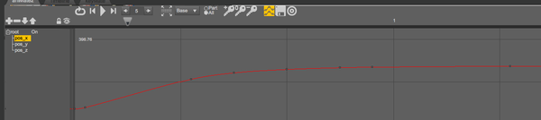

The second image is a screen shot of graphMate, after I baked the aniBlock. Unfortunately baking creates a key on every frame, but you can see how at the beginning that the line is steeper, meaning that the ball moves further to the right in a shorter amount of time.
