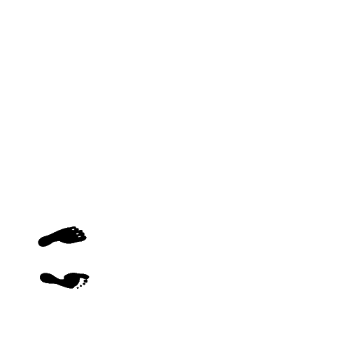

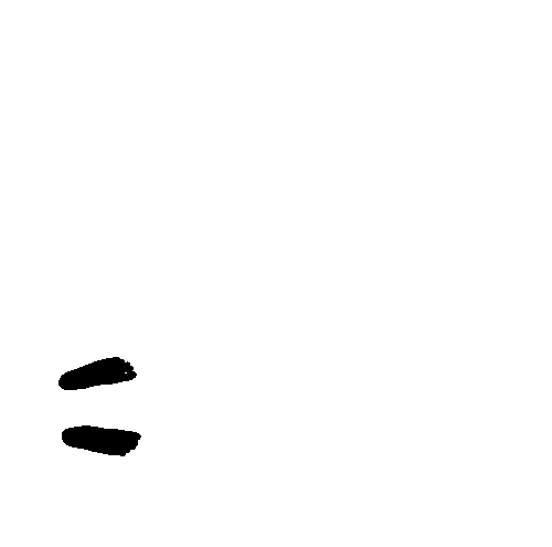

an interesting question was posed on the iClone forum about how would you create animated footprints appearing as a character walked.
I had a few ideas but trying it out, none worked.
Was something I had not thought about but can see the potential for snow displacement and lots of uses
however I do not seem to be able to create a cumulative image series video using alpha of say bottoms of feet appearing through the base of a plane etc to do it.
I have tried various combinations of shadowcatch shaders and alpha channel renders
500 x 495 - 151K
500 x 495 - 164K
500 x 495 - 120K
500 x 495 - 1M
500 x 495 - 366K

  • WendyLuvsCatzWendyLuvsCatz Posts: 38,885
    making the footprints is not the issue
    (and thx Andy will check out Sparrowhawk)
    it is the animated placing as the figure walks.
    hence the need for a cummulative image series to place in the displacement, or just bump and layered diffuse map
    making a series of images to match the footsteps easy enough but getting them to add in each consecutive frame my issue
    needs to be a series of alpha mapped images that do not show the sole when not in contact with the ground.
    hence a view of black feet invisible figure, below a shadowcatch plane with penetration against a white BG
    but you can see from my layered in Gimp gif's I cannot get the footprint forming effect.
