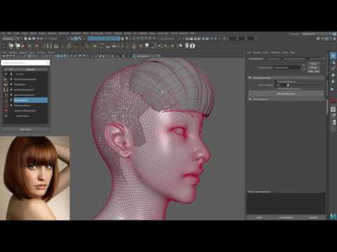

    Than i've also found a plugin that converts polygon hair, it's a plugin for Maya but could also be done for Carrara i think.
    VWD Cloth and hair (plugin for carrara) can use a polymesh hair,. and make it appear dynamic in an animation,.

  • Thanks a lot for all the informations.
    I'll do a lot of research in the last times how other 3d artists generate hair.
    Some of them are similar created like the dynamic hair in carrara but also uses different techniques.
    particles for example from blender works very similar, there you also have some kind of guide hairs and children  that simulate the most hair.
    So i've saw tutorials from people who uses this method but nearly created the full hairstyle with the guides while i often try to use as less guides as possible, only where i need them.
    I will test out different methods, on blender and on carrara to see what works best for me.
    The same about poly hair, there are some very interesting tutorials from 3ds max, maya, blender, and so on and most of them can be also used in carrara.
    I think it's pretty helpful to watch 3d tutorials not only from carrara just to see different kinds of workflows.
