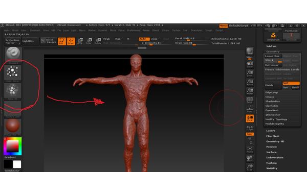

I have a problem with the export of Goz plugins from zbrush
shona_nqnshona_nqn Posts: 34
edited June 2013 in New Users
daz studio does not matter in this texture mesh ... sincerely not as do to that suits the mesh genesis..
I found this video that shows something similar but I can not see what it does. going too fast to learn
https://www.youtube.com/watch?v=OTEhFyK7Qdc
thanks for the help
1366 x 768 - 173K
1366 x 768 - 173K

    this is my problem ... as I can use this texture in daz? I export the mesh with Goz but not adapta
  • shona_nqnshona_nqn Posts: 34
    so is in daz studio

  • Richard HaseltineRichard Haseltine Posts: 104,447
    You need to bake the displacement to maps, then export the maps from ZBrush and apply them to the displacement strength property in DAZ Studio. Morphs are limited to the base resolution of the figure, and morphs (and base mesh) are what GoZ will transfer.
    It looks as if the video is using the groups or materials embedded in the tool - but the current version of GoZ isn't sending those across. If you export as OBJ from DS and then import that OBJ as a tool in ZBrush they should be preserved, and you can follow along. This would appear to be a bug - in DS, GoZ or Zbrush.

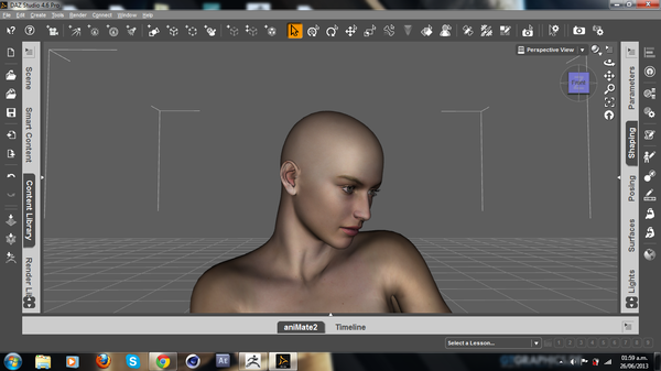

    Friend I hope you can help me I have an error when importing from Goz plugin. when importing the mesh, work for an hour after the matter, I give save and reopen no genesis mesh deformations .... not that I'm doing wrong, before he could do so without any problem.
    here I leave a final image before closing and saving
    1280 x 720 - 105K
    and so you see when I open the same file
    1366 x 768 - 455K
    There do seem to be some issues with GoZ - I've just been looking at a thread with another, even worse, problem. For now I would suggest making sure you save your morphs as OBJ from ZBrush and import using Morph Loader Pro, or at least make sure you have an OBJ export as a back-up.
