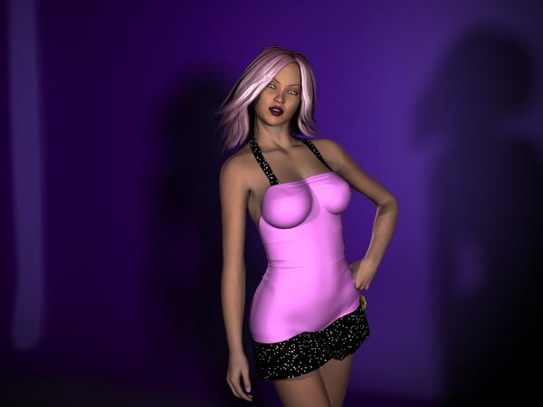

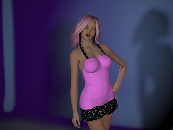

Ok here we have two Images of the Same Scene, everything is exactly the same except in the render settings one has Gamma correction ON with a Gamma of 2.2 and one has the default setting (Gamma Correction OFF and Gamma of 1)
Top Pic is Gamma ON, Bottom Pic is Gamma OFF
Which do YOU think looks like it has better lighting?

  • Richard HaseltineRichard Haseltine Posts: 104,239
    Depends on what you are aiming for - but the first has more tonal smoothness, the second is much more contrasty with sharper transitions.

    well I've been reading a lot about light and gamma, and I've been following the Cararra discussion on the Gamma Correction setting.
    So I figured an experiment was in order to see how it would effect a DAZ Studio Render with 3Delight (I have luxus and it defaults to gamma 2.2)
    this scene was just lit with 3 DAZ studio spotlights, no UberEnvironment, no area light planes. I was really intrigued when I saw how different they came out.
    my biggest surprise was how different the background is between the two renders.

    I like the top one.
    Seeing both makes me want to put one of top of the other with a 50% opacity. But I think I pick the top one.

    Your last render is better. Without Gamma correction, the renders are darker, espescially shadows
    My opinion is that using Gamma Correction really depends on what you're willing to achieve, but if you're aiming at more realistic renders, it should be ON

    could be my screen but to me the top one looks flat and boring while the bottom one is more vibrant. The third is getting there but still lacks the character of the second. But like I said it could just be my poorly callibrated screen.
    btw art isn't about faithfully reproducing reality; it's about enhancing certain aspects to evoke emotion...
    Just a thought.
  • Scott LivingstonScott Livingston Posts: 4,344
    edited August 2013
    Hmm...I partially agree...first one is more realistic, but the second is more aesthetically pleasing, I'd say. But #3 I definitely like more than either of the others.
