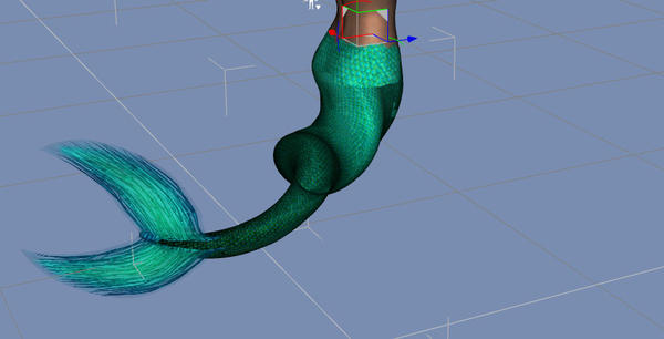

I just purchased Genesis 2 Mermaid and when I load it in Studio it is see through. As far as I can remember to fix the problem I need to flip normals. But I don't know how to do it in 3D Studio or how to fix this problem.
I attached an image of the mermaid tail to explain exactly what the problem I am having with it.
Please can someone help me.

    Does it still look that way when you render, or only in the viewport? From the product page, it seems there are trans maps involved. Transmapped hair tends to do the same thing, but will look completely fine in a render.

    If you flip the normals the items textures will fail as well as lighting. The Trans maps cause the Viewport issue not the normals.

    The mermaid tail renders fine but it is annoying to see through the mesh and it makes it harder to pose.

    You can remove the opacity map from the tail in the Surfaces pane to have a solid tail for posing, then when you are ready to render just reapply the materials preset.
