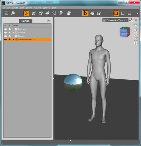

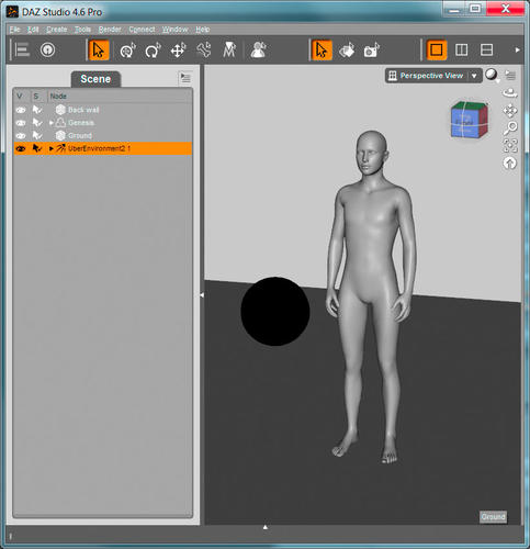

When I turn on the new per-pixel-shading option (Edit > Preferences > Interface) the UberEnvironment sphere in my scene turns black. This makes it difficult to rotate the sphere to the set the lighting direction.
These images illustrate the problem. Any suggestions?

    as a guess I think this is due to the normal pointing inward and nothing to be concerned with. The sphere is only for reference and plays no part in the lighting.

    I have noticed Per Pixel turns most dome and sphere lighting off in the viewport, they work just fine but it's impossible to set them up as you can not see them any longer.

    That is due to the mesh normals pointing outward. To change that you need to use the Geometry Editor Tool and select the whole sphere and reverse the normals.
