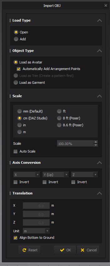

    Open MD. Click “File” “Import” “OBJ”. Navigate to ObjFiles/Bases folder and open your saved .obj file. Choose Load Type “Open”, Object Type “Load as Avatar”, if it isn’t already, check the box for “Automatically Add Arrangement Points”, Scale “cm (DAZ Studio)” click ok.

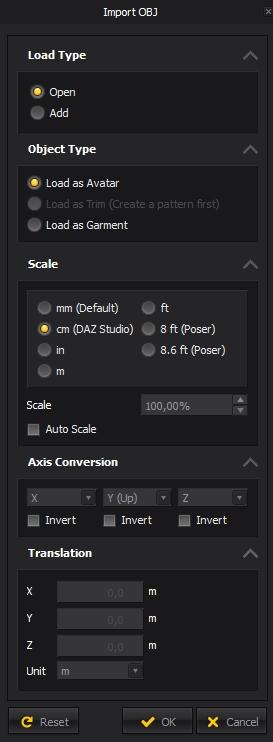

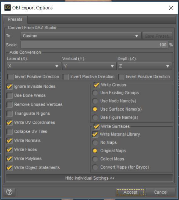

    Sorry - distracted with other things again. Just want to check the Export settings from DAZ Studio, etc. with anyone who does this regularly. Here's mine ...

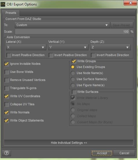

    Here is what I used last time (made a jacket for G8F ) for DS 4.10 and the ones for MD7. I didn't update (yet?).
    That way my avatar has no texture of course.
    477 x 553 - 116K

    I never do understand the DAZ Studio export settings so it is usually trial and error until something looks like it works. I had a similar problem with Blender and there seem to be differences in preferences depending upon who you ask.
  • xmasrosexmasrose Posts: 1,408
    Me neither.
    All I can say is these settings work. Are they the best? I don't know.

    I think my settings export the figure complete with skin textures. At least, when I played with other settings I was getting a white avatar in MD8 - which is OK but I wanted to see if I could get the figure complete with texture.
