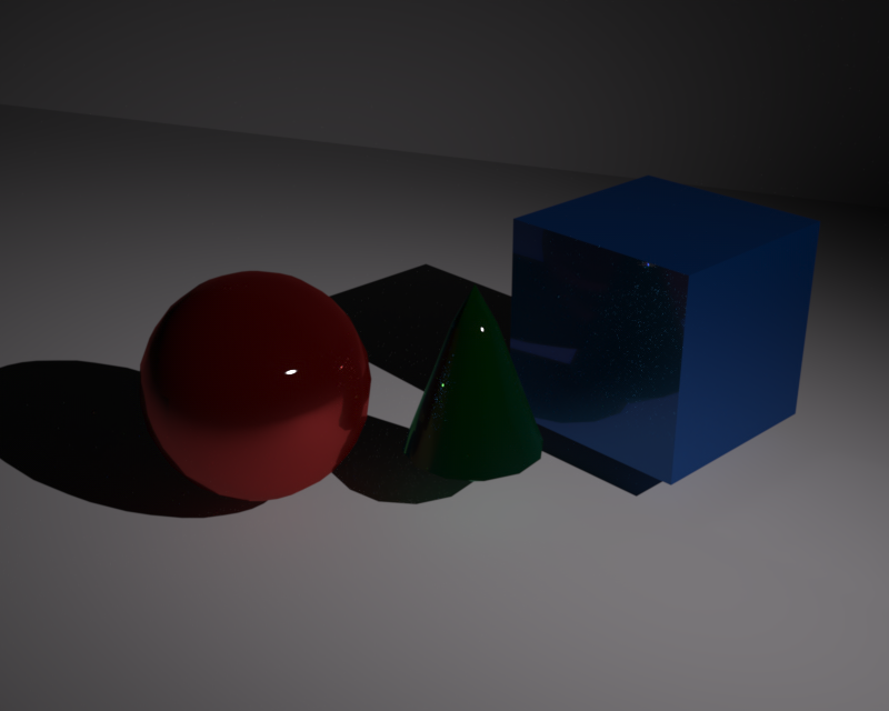

This isn't correct. In the image below I have a spotlight using point geometry.

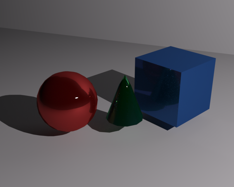

Compare that to this image where I'm using a point light.
The lighting profile is considerably different. Especially pay attention to how the point light is lighting the two planes for the floor and wall compared to the point based spotlight which is mostly focusing it's light on the primatives in the center.
All the geometry on the spot light does is change the origin of the light rays. They still only travel in the direction of the spotlight beam. For instance, see the image below where I changed to a 10x100cm cylinder. Especially note the way the cube's shadow on the top edge is affected by the geometry of the emitter, spreading out laterially, but not longitudanly.
