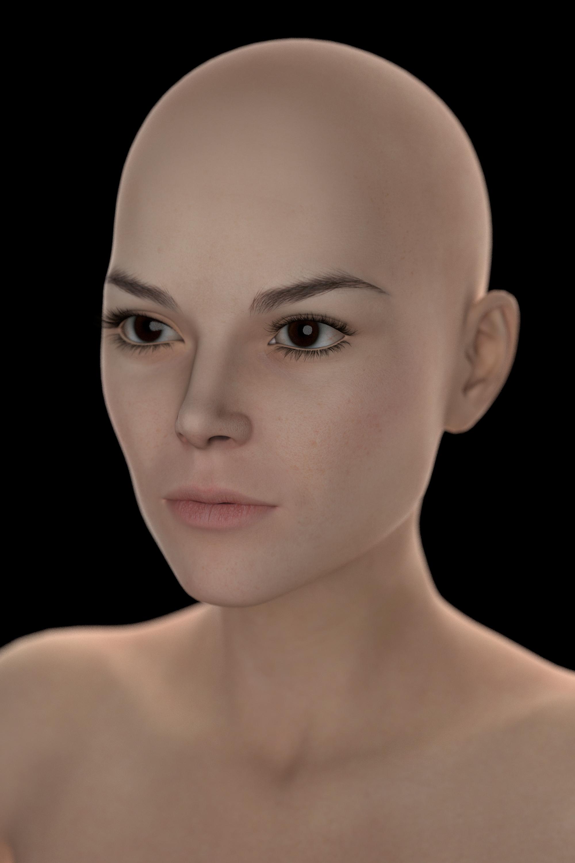

    Here is a scene with a simple Universal material setup I used in these images:
    Textured Lights
    CustomShaderTextureLight
    HDR Environment
    CustomShaderHDR
    Open or merge the attached duf with material and save it as a preset under the Octane material tab. Let autoconvert take place when you load a character so the maps will show up in the list for quick access under N.G.E. (node graph editor). Place your diffuse map in the albedo RGB node using the dropdown. Bump in bump and specular in specular. If the model your using does not have a specular map you can follow the video I linked above for making one. For the eyes just use the autoconvert with the "Clear Cornea" for the cornea from the live DB.
    duf
    duf
    CustomSkin1.duf
    33K
    2000 x 3000 - 3M
    2000 x 3000 - 3M
