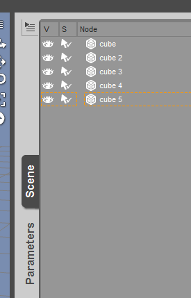

Hello?
I am using daz studio 4.6.
in scene tab, clicking 'eye'-shpaed icon makes object invisible or visible.
But how can I make many objects invisible at the same time?
clicking all the objects' eye-shaped icons takes so long time...
I want to recude working process.

  • kitakoredazkitakoredaz Posts: 3,526
    edited January 2014
    there should be many way, eg script,
    (Sorry, I mssed and tell wrong ^^; edit )
    I often create group from top menu. or use select children.
    then go to parameter tab. general>display
    or select them in scean then go to surface tab, I use opacity setting.
    (I think there were way, to change visiblity ot once,, ,,)
    edited January 2014
    :down:
    making group seems only work,,,
    there are many different case,, about hieralchy,,
    about figure, (rigged) top node visibility decide all children,,I think,,
    about obj , parent node can not decide visiblity of children,,
    but create group, it work.
    Post edited by kitakoredaz on
  • JaderailJaderail Posts: 0
    Only a Group will give the Ability to Turn off everything in the Group. I find it useful on crowds of figures as when they Have been grouped it will turn off all nodes in rigged figures. No other way will.

  • Richard HaseltineRichard Haseltine Posts: 104,134
    You could also select them all and then use the Visible button in the the Display group in the Parameters pane.
    edited January 2014
    Hi,, RIchard no I could not ^^;
    if it worked before? I thought so. but at current I can not .
    it only work about frist obj.
    or is there any setting?
    Ah,, I remember,,
    I need to check on "consolidate" , in parameter option.
    when I check it, it work.
    I do not know there is another setting or not.
    Yes, the combination of Consolidate Properties and Show separate items will stop multi-adjustment of parameters from working.
