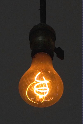

In Poser, how do you make a model of a lightbulb, which is visible in the scene, glow? I know how to make a point light create a glow, but I don't know how to make the lightbulb itself look as if it is creating the glow. - my example image of the lightbulb is in the public domain on wikipedia - here: https://en.wikipedia.org/wiki/File:Livermore_Centennial_Light_Bulb.jpg

  • macleanmaclean Posts: 2,438
    The usual way is to use Ambient Color, but it depends on the lightbulb's materials. Some of the models I've made have separate materials for glass, filament, etc, so it's fairly easy to control the different elements. If its just a bulb with a single glass material, you can make use Ambient and Opacity to get a 'pearl' bulb effect. Go for a warm orange Ambient Color.
    mac
  • RKane_1RKane_1 Posts: 3,037
    You can also, I am told, use Area Light on the filament but I am told that this may not be sufficient to cast light as far as need be and so an additional pinlight may need to be added.

  • RAMWolffRAMWolff Posts: 10,331
    Yea Ambient is the way to go. I know it works in DS. Ambient is one of those surfaces that is very glowy so if you were to do a dark scene but had, say skin, set with too much Ambient, it would have an unnatural glow to it. SO I imagine that applying that to a light bulb or the filament inside of the bulb (if the artist bothered to include that, would cause it to glow.

  • Ken OBanionKen OBanion Posts: 1,453
    You might also try applying a probe light to the filament surface. I've use those to make, for example, runes glow. Of course, the object you're trying to make glow needs its own material zone, but I'm assuming you already have that covered....

    Ambient is a part of the surface settings. Just like Diffuse and Specular. It should already be available on your light bulb, you just need to set the strength value to something (probably a number above 80%, but experiment to see for sure) and the color value to the color you would like the surface to appear (yellowish orange most likely).
    I'm really struggling with this because it is a "pet peeve" of mine to call Ambient the "glow" of a surface. See my blog entry Diffuse, Ambient and Specular for more information about what I mean. Poser users and content artists have used the Ambient surface channel for glowing effects for years, however, so this is "tried and true" advice that Maclean started. :)
    Two things to keep in mind ... using the Ambient surface settings does not actually make the surface glow. The surface appears to be glowing because the rendering engine is adding color to the surface even when there are no lights in the scene shining on it. However, it will not emit light on to the other objects in your scene. You'll still need a point light located inside the light bulb if you want the bulb to cast light/shadows on your scene. If you do that, make sure the surface of the light bulb is also set to NOT cast any shadows.
    Second (mostly for others reading this), this trick works less well in DAZ Studio. The reason is that in the default shader for DS, the Ambient and Diffuse channels are linked together. This is by design and conforms to Pixar's Renderman reference shaders. However it can cause some confusion when people bring content into DS using Poser material settings since Ambient doesn't work quite the same way. The good news is that DS users can apply an Area Light shader to the light bulb surface that actually makes the object emit light. :)

    Go to the Material Room (why are they called 'Rooms', anyway; that makes absolutely no sense!), and select the 'Advanced' tab. Use the 'Object:' and 'Material:' drop-downs to locate the filament surface material. Then look for 'Ambient_Color' and 'Ambient_Value' (they're, like, the seventh and eighth items on the 'Poser Surface' panel); those are the items you want to play with. Pick your color (a nice, warm, pale-yellowish, as maclean suggested), and dial up the value. Render. Tweak. Re-render. Repeat as necessary. (And I challenge you not to start sounding like Scooby-Doo while you're doing it!)
