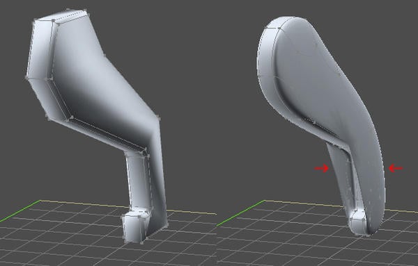

Hi, This is my first post. I tried searching the forums for an answer before posting but couldn't find anything. Frankly, I'm not sure what to search for.
Anyway, I'm creating a shape in the vertex modeller and when I smooth it, the polygons kind of stretch out over the area where the geometry curves. I'm not sure how to fix this.
A picture is worth a thousand words so here is what is happening. Anyone know how to fix this? Thanks!
656 x 419 - 64K
  • evilproducerevilproducer Posts: 9,050
    The broad face of the object appears to be a single polygon. Try linking some of the edge vertexes with the link tool. Particularly where it bends. I should add some stability to the mesh.

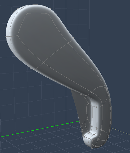

    Thanks evilproducer! I've only done one side so far but that works perfectly.

    In your first screen shot, the largest polygon(or face) of the object has what is called an N-Gon. An n-gon is a polygon with more than 4 sides.
    When you use smoothing on a mesh that has n-gon's, Carrara's modeler will(afaik) triangulate to the center of an n-gon. Depending on the shape of an n-gon, this triangulation may result in creating new polygons through or over other topology.
    To avoid some smoothing issues with n-gon's, you can triangulate them first. In the vertex modeler make selections and use Model->Triangulate Polygon, or Model->Triangulate n-gons(> 4 points). N-gons are fine for some models though, it just depends on what you need. Hope this helps.

    Not just Carrara, either. As tbwoq says, it's always good to remove nGons by linking vertices until you get four vertices per polygon.
    It is also good practice to try and make all polygons equal four vertices. This is very popular modeling and some of the pro figure modelers are really fast at not only building this way, but at recognizing when they equal anything but four. Smoothing (SubD) is one thing, but lighting is yet another concern.
    Some modelers use trigons instead, where each polygon has exactly three vertices. One of the functions that Carrara has is to convert quads (or higher) that are not flat into trigons. This is so that the light isn't messed up when a quad has one or more of its vertices laying on a different plane that the rest, making the actual polygon distort.
