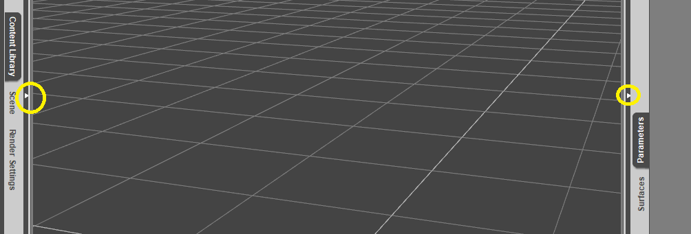

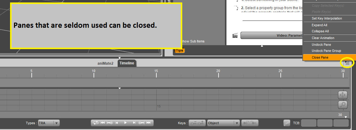

  • Catherine3678abCatherine3678ab Posts: 8,455
    edited February 2020
    If one clicks on either the tiny arrow or on the header for an already open pane, the mass will slide over.
    For panes seldom used one can close them.
    1168 x 426 - 36K

  • LoonyLoony Posts: 1,817
    yeah I know how to do THAT :D but I wanna close/open them via pressing TAB.

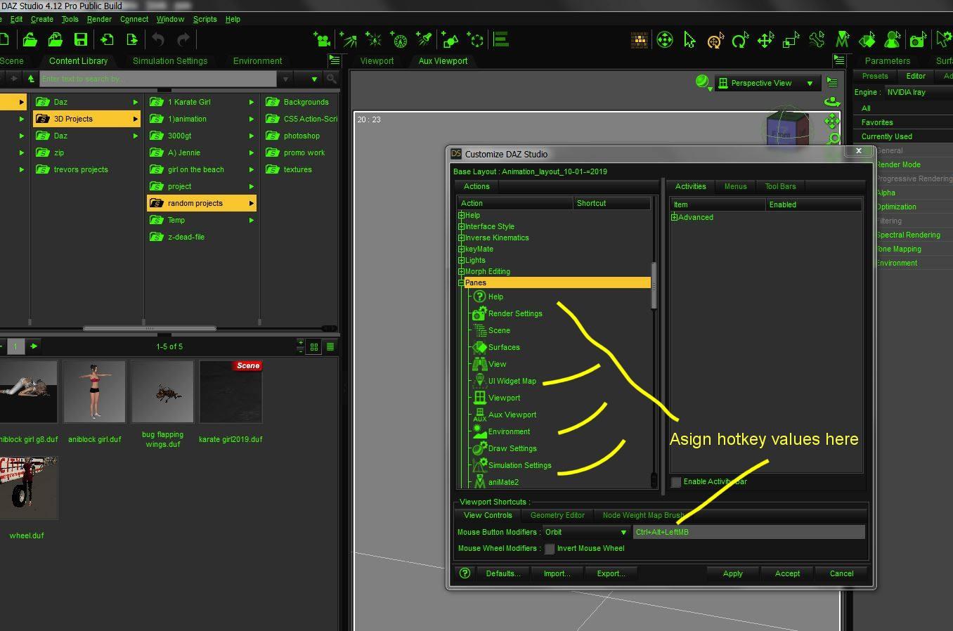

  • IvyIvy Posts: 7,165
    How you can find the Hotkeys menu in daz studio by~
    Step 1 open daz studio
    step 2 along the top of studio go to "Edit"
    step3 scroll down to "View" . This is your hot key short cut menu
    If you want too customize your work space panes do the following ~
    Step 1 open Daz studio and go to windows on top/
    step 2  scroll down to until you see "workspace" and click it
    step 3  scroll down that menu to customize and the customize options panel will pop up.
    step 4 on the left side of the panel scroll down until you see "panes."
    step 5 choose pane you want to assign a hotkey for,  you assign the hotkey at the bottom of the customize option panel see screen capture
    step 6 when you happy with your customized hotkeys click accept and your done
    pretty easy..  I hope that helps
    1356 x 898 - 133K

    Also Your hotkey setting method in Step 6 is wrong, you pointing on the View Control at the bottom, that is not where you set a new Hotkey, there you remove your Mouse control for the viewport, for rotating the view/camera.
    You have to rightclick there:
    and IF you add a hotkey to one Pane, then it will REMOVE the pane if you press the button, if you press it again, it will open it as new window.
    I show it you:

  • Short cuts for actions are set by right-clicking on them, choosing the change command, and hitting the new combo. The area at the bottom is for setting the Viewport modifiers (for changing the view and for tool actions).
    yepp... thats why I was confused why Ivy said I should change it there O_o...
    yes you are quiet right . I stand corrected . please right click the pane of choice you want to assign the shortcutkey to. my apologies for the confusion.
    1648 x 1032 - 140K
    Post edited by Ivy on
    But IF you do that, the hotkey will destroy your UI... see my screenshots:
    https://www.daz3d.com/forums/discussion/comment/5344606/#Comment_5344606
    it will undoch the panels and open them then in a popup <_<

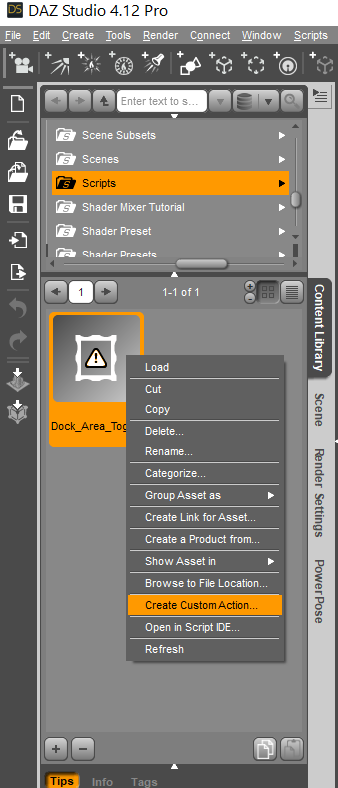

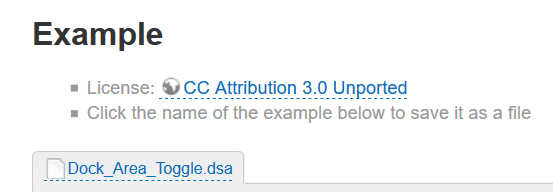

  • There is (now) a sample script showing how to toggle the dock areas (the areas in which panes are docked). http://docs.daz3d.com/doku.php/public/software/dazstudio/4/referenceguide/scripting/api_reference/samples/general_ui/dock_area_toggle/start
    but how can I put a hotkey on a script?
  • Sorry, looks as if I garbled my attempt to explain this earlier - find the script in a content pane, right-click on it, and select Create Custom Action. You can then find it in the Custom Actions group in Window>Workspace>Customise and ssign/modify its shortcut as with any other action.
    Hay that script works beautifully, thanks Richard.
    edited to add some pics and also a free icon for the script if anybody wants one of those too. {some browsers handle pics differently, be sure it's a .png file for the folder}
