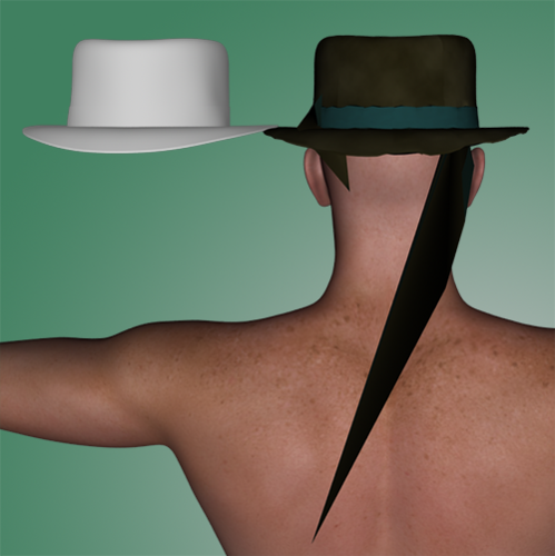

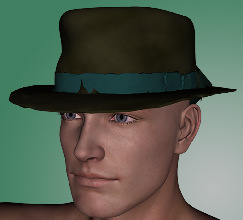

I'm really hoping somebody here can figure out what's going wrong!

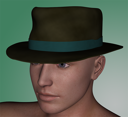

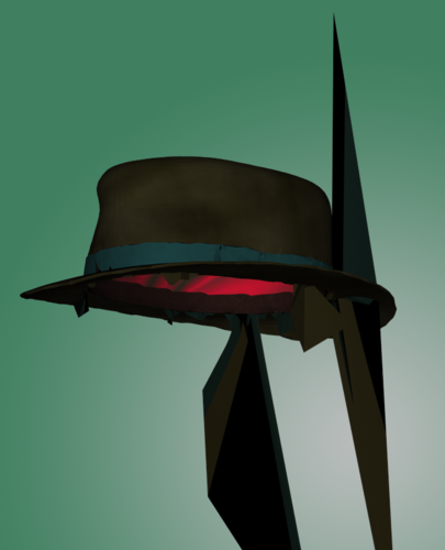

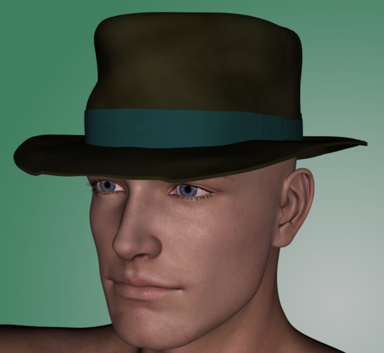

I'm working on hat for Genesis, you can see it in the first picture. The figure in the picture is the Genesis basic male figure. I'd really like the hat to fit all the Genesis characters. But when I scale the basic male figure to Michael 5 the hat goes all wonky, as you can see in the second picture.
That just won't do. So, following the information I gleaned from this tutorial: DAZ Studio 4.0 CCT - Morph Clean-up Part 2, http://www.youtube.com/watch?v=O-SKYTOkVo4 I exported the original hat as an .obj file and fitted to the M5 figure and used the built in Morph Loader Pro plugin to fix the morph to M5. The Morph Loader Pro settings are picture 3 and I don't get any errors when I click Accept.
However, Power Loader Pro totally fubar's the morph .obj! As seen in picture 4. Picture 5 is a rear view of the fubar'd morph with the morphed .obj imported next to it. The one vertex that pulls down is way odd! What I really don't understand that when the .obj used for the morph is so smooth that the Morph Loader Pro turns it all jagged.
Can anybody possibly suggest a fix to this issue? Or does anyone have a better solution for setting up the dynamic FBMs for the base characters?

  • kitakoredazkitakoredaz Posts: 3,526
    edited March 2014
    I think if you change vertex order, when you modify the shape as morph.
    if it keep vertex counts, you can load the obj as morph. but if you have changed vertex order of obj,
    (eg you cut some vertexs then translate, and joint again, or you use tool of your modelor,
    which change vertex order. )
    it break, when you apply the morph.
    And you may need to check your export and import setting of your modelor.
    eg, if I use blender, I must need to check option to keep vertex order when import and export obj
    to make morph.
    then just to confrim,,
    when you fit your hat to genesis, then apply FBMmicheal5,
    M5 change root node scale to 103.8 % (Edited ^^;) by ERC of FBMmicheal5.
    so that the hat change scale to 103.8% too.
    If you keep the scale, when you export the Hat as obj to your modelor,
    then modify and import morph , and overwrite morph which generate as FBMMicheal5.
    it should double apply M5 scale size.
    to avoid these scale problem , you need to export hat obj as genesis root node scale.
    (turn scale to 100%) when you export the obj.
    and modify it witch can fit well for M5shape 100% node scale., not actual Micheal5 scale.
    (though I do not know you already adjusted the scale,
    then it is not about the current problem)

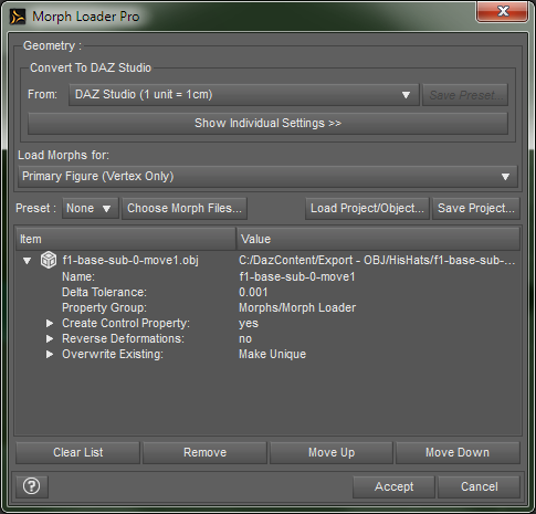

    Okay, I'm going to try to start all over from scratch, and list the steps along way to see if you can spot any places where I need to change things.

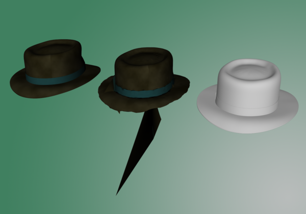

    --- Test One: 3D Studio Max Move Morph ---
    1. Open up DAZ Studio
    2. Bring in hat into the scene, the hat is the only item in the scene
    3. Set Subdivision to Zero
    4. Turn Interactive Update ON
    5. Set Surface Angle smoothing to zero

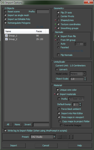

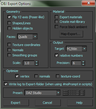

    6. Export hat as .obj file (export settings shown in first picture, since it was just for sizing/morphs I didn't export any material/surface information)
    7. Import hat .obj file into 3D Studio Max (my modeler program, import settings in second picture) [Note: It turns out that the two sections are head and neck, with about 30 faces being part of the neck, I believe this if from the transfer utility and it did this when I set it to long hair. I thought that this was the reason for the morph issues but vertexes that are part of the head are also getting put out of whack. I will adjust the bones setup for the hat at a later date and see if that has any effect on things]
    8. Moved the hat.obj 1 cm forward
    9. Exported hat.obj as new obj for morph test (third picture. Again, just for sizing/morphs so no material information included and export done in quads)
    10. Back to DAZ and open Morph Loader Pro
    11. Select moved obj for morph, with not changing the name of the morph and making unique for test purpose (settings shown in fourth picture)
    12. Morph created successfully
    13. Test morph
    Morph pooched >:-(

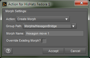

    --- Test Two: Hexagon Move Morph via Hexagon Bridge ---
    5. Send hat to Hexagon via bridge
    6. Moved the hat.obj 1 cm forward
    7. Send hat back to DAZ via Hexagon bridge
    8. Morph Loader Pro does not open, an Actions dialog box opens, not sure what's up with that. (see below)
    9. Test morph
    Morph pooched >:-( Although not as bad as before, but still pooched.

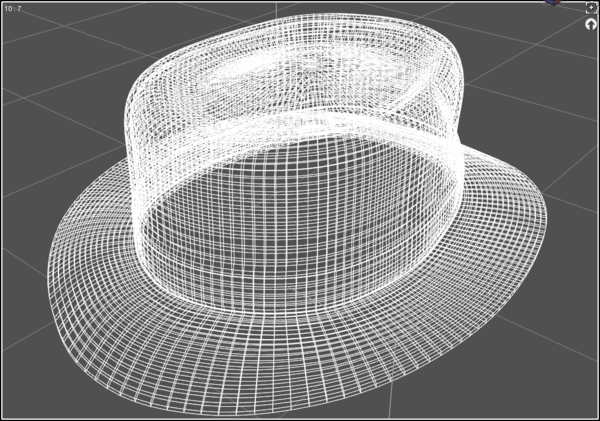

  • WinthrodWinthrod Posts: 66
    Additionally, here is the wireframe of of the hat you requested. It is all quads.
    975 x 684 - 3M
    Can you see the strange effect, when you use ds default hair or clothings for genesis, then make simple morph just for test?
    if it is setting problem(morph loader, or import export,,smooth modifier etc,, , when use other hat or wear,
    it may happen too.
    if the problem happen about your hat only,, you can concentrate about your hat,,, I think,,

    The second problem I noticed that the hats were essentially one sided, whereas I was making my hats with a full inner lining, a fully shelled 3D object. None of the other hats did that, if the brim was thick it just went in to the head, it didn't fully go in where you couldn't see the inside.
    By halving the geometry and eliminating the inner lining morphs now don't make the hat go all wonky! :-)
