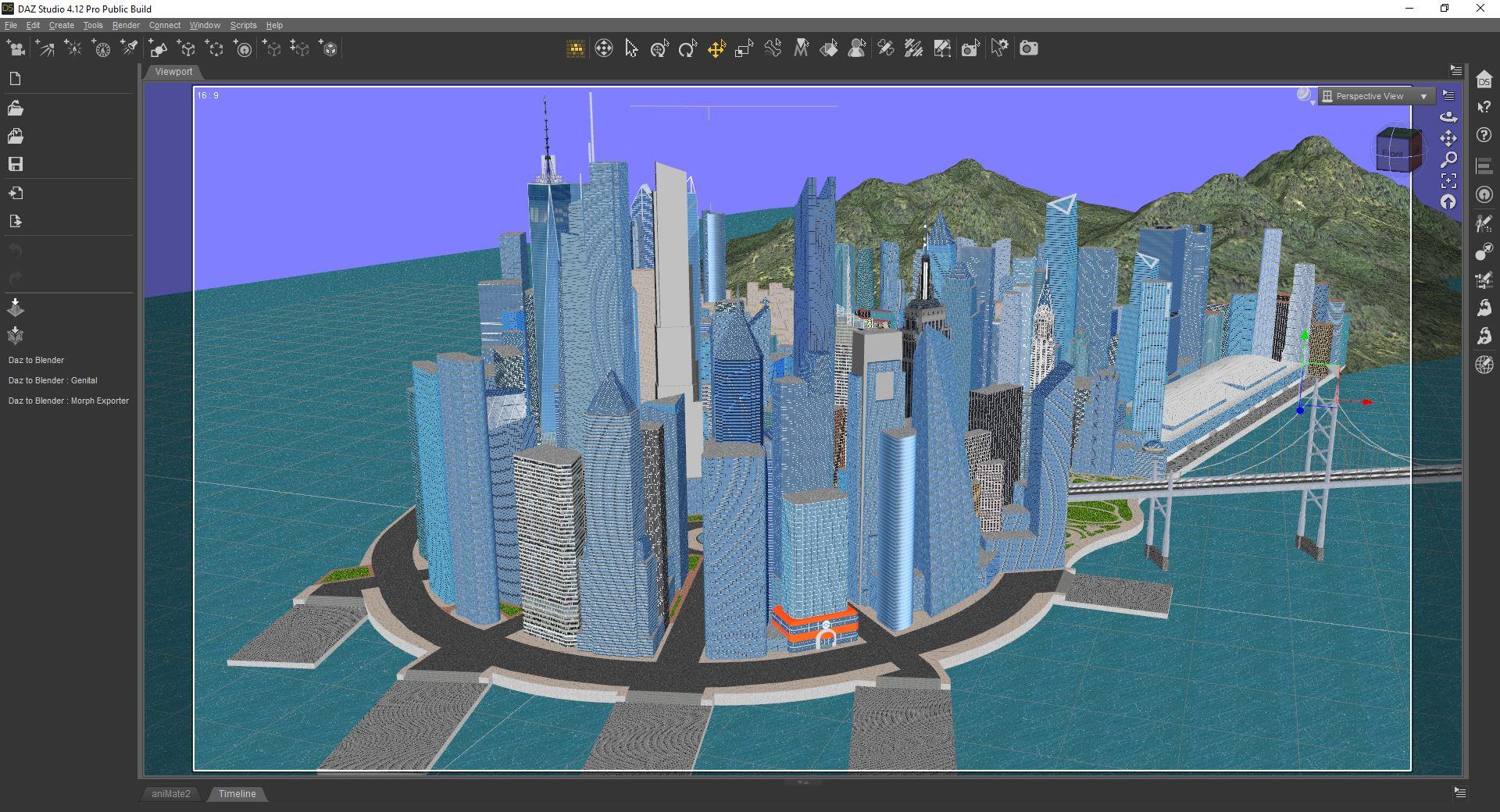

City and Textures
Found this city and it looks great except for the fact you need to add the textures but its not working correctly, anyone know why

  • LeanaLeana Posts: 12,103
    What city is that? Is it provided in DS/poser format or is that something made for another program that you imported?
  • SimonJMSimonJM Posts: 6,009
    It says it has textures but is also not UV-mapped - grabbing it now to look, not that I am an expert!
    Ok ... the .fbx version seems to load ok - not fully checked all texture files load
    The .dae does not seem load at all well
    The .obj loads, but ... to start with it loads no textures, so ... take a deep breath and .. edit the .obj file to put quotes around the name of the .mtl file (it has a space), or remove the space from the filename and rename the .mtl file in the directory to match. Then edit that .mtl fiel and correct the pat names on thll the map_Kd options (a mass change of 'Castelia City/' to 'Textures/'

    Usually, I would just add textures manually, but there are way too many to individually load with this obj.
    What SimonJM said is corect.
    1. Open OBJ file in Notepad or text editor - then remove the space in the mtl file name reference (this reference is found after 'mtllib' in the OBJ file)
    2. Open MTL file in notepad or text editor, find and replace all instance of 'map_Kd Castelia City' with 'map_Kd Textures'
    2. Set up your directory like in the image attached (i.e., change names to remove spaces)
    3. Make sure when you import obj into daz, you have 'read material library' checked

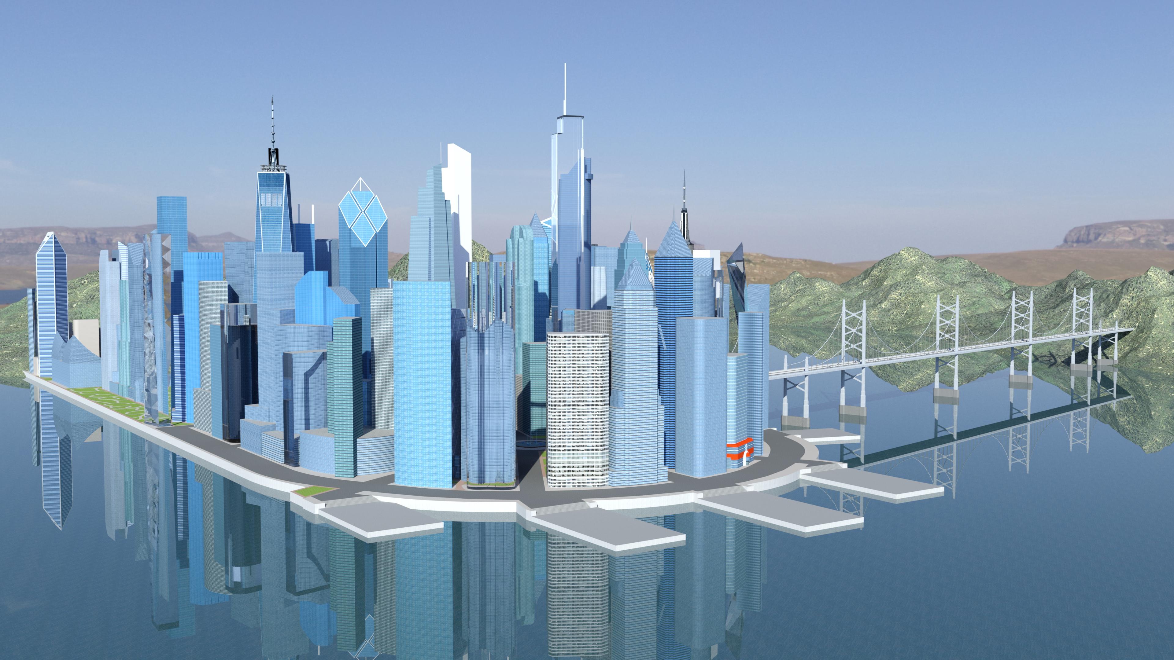

  • WendyLuvsCatzWendyLuvsCatz Posts: 38,933
    edited August 2020
    join and grab it from here
    https://3dwarehouse.sketchup.com/model/21024f61-8715-4452-b939-79fe281f82b3/Castelia-City
    save as sketchup 2020
    grab and register this
    https://pcon-planner.com/en/download/
    and export an obj
    seems fine but with my CPU being 100% used by Carrara I am not going to try and render it right now devil
    edited August 2020
    well the original from Trimble exported from Pcon works fine for me
    I will not download the version from your link (OP) as don't trust the site
    iray render
    added a HDRI to dome from HDRi Haven
    3840 x 2160 - 5M
  • Do you have a link to where I can get that one thats working for you?
    in my post are the links for Trimble 3D warehouse and Pcon planner
