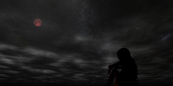

I tried to reproduce this with Carrara's Realistic Sky Atmosphere today but found that it doesn't work well at all for any kind of night sky. Once the Night time setting is turned on the light does not react with the clouds and they turn black. Moonlight should pass through the clouds and when I look out at the full moon tonight it's there glowing behind them.
The best work around I could come up with was to trick Carrara. In the scene I've used both a Sun Light and a Moon Light with the brightness of the sun set to 0%. I also lined up the sun and moon lights to be at exactly the same angle. In the Realistic Sky Editor I set the Sky Color Control to be black. The Sun Size was set to 0% but I used the sun's aura. Any use of atmospheric haze only makes the night sky white so I used black fog to get a fade toward the horizon.
There are some plugins that can create a starfield background but I don't have them so I Googled and downloaded an image with a clear detailed picture of the Milky Way and stars. The necessity immediately arose to be able to change the angle and rotate that background picture, so as quick as my fingers and mouse could tap and click away I invented my own simple plugin code to achieve that. The image brightness needs to be turned down when the moon is fuller for realism. This plugin needs a bit more testing but could prove useful.
I thought I'd share this and to ask if anyone else has tried to render a Realistic Night Sky.
1024 x 512 - 229K

    yes carrara's moonlight is severely lacking light, your workaround worked well

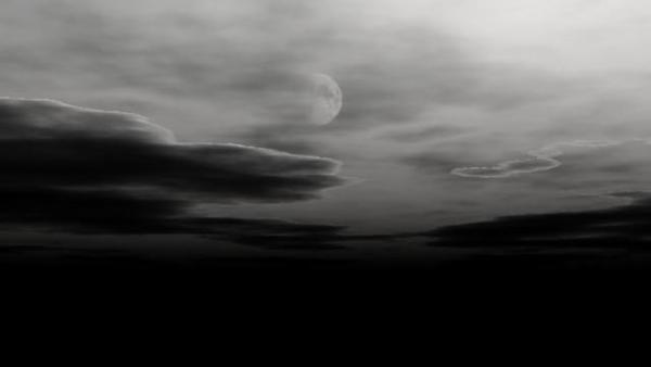

    I have played numerous times with the sky editor to render a night sky. It is difficult in Carrara.I have only one moonlight at 50%, and then I set the color of the sky to black. I play with the global brightness. I check the moon and the sun in the editor and also play with the auras. I also put the fog to black. The first pic is the result.

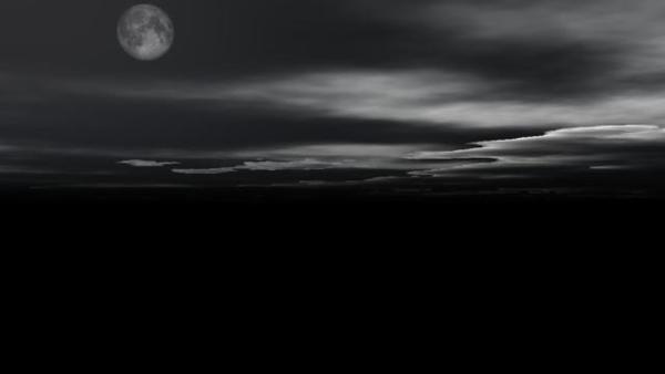

    Thanks for sharing your method. It is innovative. I followed it to the letter. I think it might better than my method. The second pic is the result.
    640 x 360 - 10K
    640 x 360 - 11K
