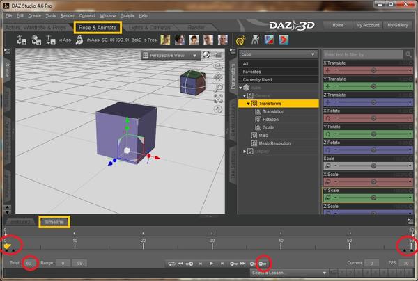

    Now I am getting excited about this new thing I have learned to do, and while playing with the rotating parameters and making my straw spin around, I was wondering if there is someway to apply changing the parameters of an object to an animation, in other words to make an object constantly spin, like a barber pole, for example?
  • BlackFeather1973BlackFeather1973 Posts: 739
    In the 'Pose & Animate' workspace you'll find the Timeline pane (you can also access it from Window -> Panes (Tabs) -> Timeline).
    By moving the yellow arrow you can scrub through an animation and set parameters where you want them.
    By default the timeline has 31 frames, wich will give you a 1 second animation.
    For this example i've set the number of frames to 60 (lower left corner : Total number of frames), thus to rotate completely my object will have to rotate 6 degrees per frame.
    Frame 0 will be the starting position for the animation, with no rotation applied. With your object selected, click the Key with a plus sign. This will add a keyframe to the timeline, telling Daz Studio that at frame 0 we want the object in it's current state.
    Frame 59 will then be our last frame, after that the animation returns to frame 0 and starts over. Move the yellow arrow to frame 59 and set the objects rotation to 354. Changing a parameter will automatically add a keyframe to the timeline.
    If you now play the animation, you'll notice it doesn't rotate continiously. The animation starts slow, then speeds up and slows down again at the end. This is because Daz Studio uses 'ease-in ease-out', wich makes for nicer movements on figures.
    However, we don't want that her. To get rid of that, set the object's rotation on frame 1 to 6 degrees and on frame 58 to 348 degrees. This way we force the animation to start and end at 6 degrees per frame. The rest af the frames will be interpolated correctly.
    Hope this helps.
    If you want to learn more of the basics of animation in DS, there's a free tutorial in the shop : http://www.daz3d.com/tutorials-old/great-art-now-bonus-animation-101.
    1049 x 706 - 181K
