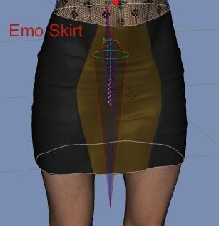

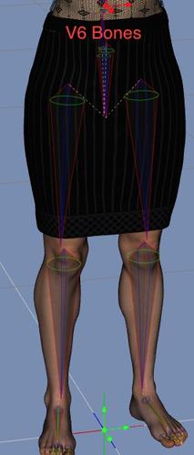

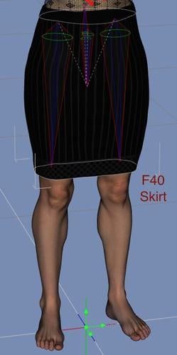

Here are some screen shots to illustrate what I mean. In one skirt, the bones are not aligned with the figure bones and in the other there is only one bone to handle both legs. Surely this is why the skirts don't pose nicely? Or am I understanding the concept badly?

    Interestingly, if I go down the hierarchy and select the Left Thigh on the EmoSkirt and then bend it in the parameter sliders, it seems to bend but as soon as I release the mouse button, it snaps back to its initial pose.

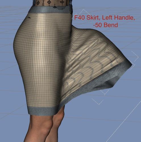

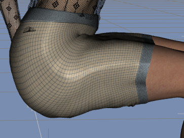

    On the F40 Skirt the bend stays after releasing the mouse but the skirt somehow balloons out of proportion. I've used a different texture here to highlight the distortion. I should add that the other screen shot shows that the included "sitting" morph does do a better job (if both legs are bent equally).

    The Emo skirt has the bones from G2F, presumably for better conforming, but doesn't actually have them set to control the mesh - I'm not sure why, given that, there's an visible effect when adjusting them though I see it too.
