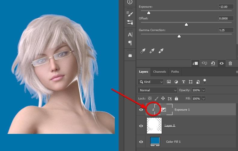

I only bring exr file into Photoshop for post-production. First I have this exposure issue. All the tonemapping in the render settings can't reduce the exposure of exr. You have to manually create an exposure layer and change the exposure value to -13 to -14, to get the result close to PNG rendering. Then this alpha issue also appears in the exr, when I overlay it on top of a solid layer in Photoshop. It seems like only stranded hair has this issue. Other polygon hairs with transparency maps (image 2) don't have this issue. Any thought?

I think I followed
So I opened up the exr
and this is the result
Normally I would go into Image -> adjustments HDR Toning but it takes away the transparancy :-/
try Grouping the Layer and the adjustment on top of your background
Thanks again, Wallace. Your way of putting those layers in a group folder is the same thing as this "masked layer". I tried your approach and used gamma 1.25 in my setting, it doesn't solve the problem.

1.25 was for my specific render to get the lighting good. otherwise the character had to bright of highlights.
