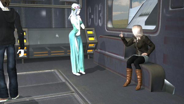

This happens randomly. Without changing anything in the scene It will render normal one time then with glowing skin another. Only certain skins seem to be affected. This scene has Karynna skin and Grey Alien skin. The non glowing character has Bree Skin. I've had this happen randomly in different scenes.

  • srieschsriesch Posts: 4,243
    Does it fix itself if you exit and restart DAZ Studio (if you are using DAZ Studio)? There's some kind of bug that intermittently causes objects to be rendered white instead of using the shader the way it normally works, but if you try again it will return to normal.
    Could it be ambient? Normally you want that parameter in the surfaces to be set to zero unless you are intentionally doing it for some reason.
    Could it be reflection? No idea what, if anything, would be a normal setting for reflection for skin, I would guess nothing normally but if it's wet maybe it would have some.
  • DarthDDarthD Posts: 259
    Yes, restarting will usually correct issue. It did it a lot in the previous version. I thought it was fixed with the upgrade to DAZ 4.7 because I had not seen it since the upgrade until recently.
    Both glowing skins have ambient SSS set to 100% which is minimum. The Bree skin does not have an ambient SSS setting. I just reopened and rendered and all is normal again.

  • BejaymacBejaymac Posts: 1,908
    It's an old issue with Shader Mixer created shaders, the shader data is compiled from the brick data at render time and from time to time it becomes corrupt, which leaves the render engine with no idea what to do for those surfaces, so it renders them pure white.
    When you get this when your working inside the Shader Mixer you just need to click the apply button, as DS will then see it as a new shader and compile a new shader file for it. The problems start when your using presets or in your case AOA's shader which uses a DSF asset, doesn't matter how many times you reapply them as DS sees it as the same shader, and keeps on using the corrupt file.
    Closing DS or manually finding the shader file and deleting it are the only ways to force DS into compiling a new file.
