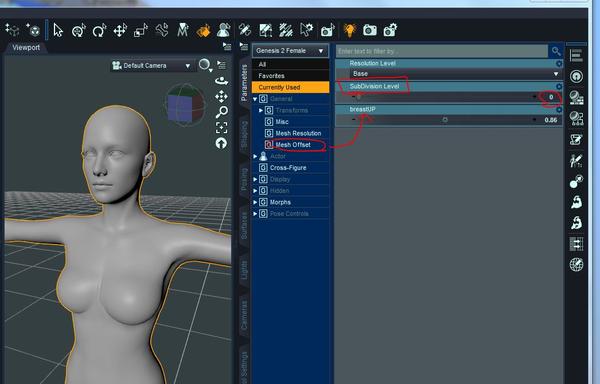

  • kitakoredazkitakoredaz Posts: 3,526
    edited April 2015
    When you export pushed shape, (you can use pusu modifier node weight map too to push only some part)
    Have you set the genesis2figure sub-D as zero?
    without it, your export obj do not much genesisfemale vertex count. then cause loading erroer.
    about push modifier, it never change vertex count . (I have already tested and made morphj,
    then push modifier never change vertex count,
    and it can load as morph without problem;-)

  • jsdaz_5811013940jsdaz_5811013940 Posts: 119
    Kitakoredaz,
    Success!
    Zero G2F figure
    Apply morph at Max value (1.0)
    General -> Transforms -> Mesh Resolution -> Resolution Level = Base
    General -> Transforms -> Mesh Resolution -> SubDivision Level = 0
    File -> Export -> .obj file (using Daz3D defaults)
    Edit -> Figure -> Morph Loader Pro
    Worked a charm.
    You are right, the transition may not be movie quality. But, my morph is constant for the character, so this is not an issue. I find the push modifier very easy to use. Others might find it very difficult. It would be nice to be able bundle the push modifier with the morph like a Dformer. Oh well, not a big problem. This will go a long way to helping me morph all sorts of models. Cool!
