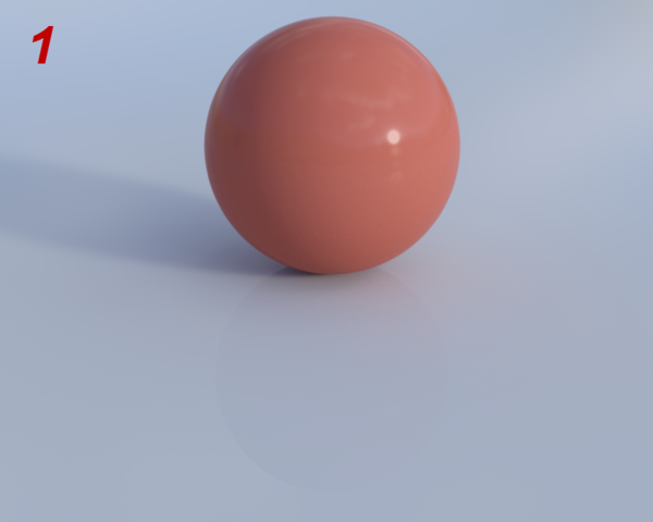

    I have default scene. Have added a sphere (sphere added just for something to reflect).
    Have added Plane with default "Iray Uber Base" shader. Have changed base mixing to "PBR Specular/Glossiness" and Base color to 0.63,0.63,0.63. (Render Pic01)

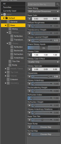

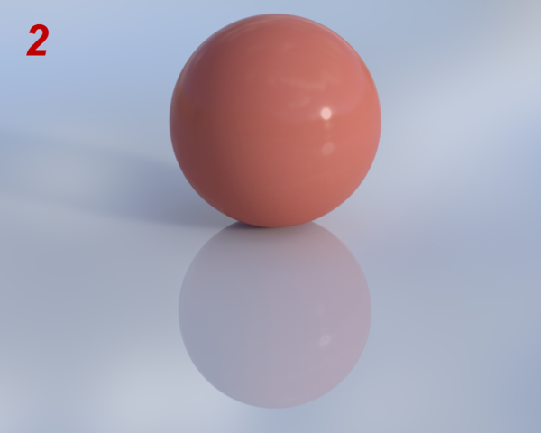

    In shader change Glossy > "Glossy / specular" color to 0.69,0.69,0.69, which increases glossy reflection (Render Pic02)
    Change Glossy > Glossiness value down to 0.9 which will blur the reflection (the lower that number, the more blurred the reflection will become.(Render Pic03)
    Shader settings pic attached.
    Those settings do not need to be that specific, I just set those for example. But it may give you an idea of what settings to use.
