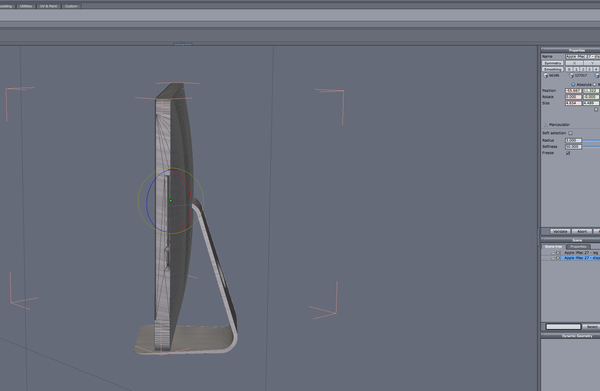

I found a really nice computer model for free at an other 3d asset site. It came as an OBJ file. After fiddling with it, I've gotten it to work great in Daz, with 2 of them parented, and polygons removed so it can tilt up and down. (That's how a FBX version of the file asks, but it's geometry seemed messed up so I wasn't able to texture it right..but since it came as two objects, i'd be in the same boat with it).
I'd like to save it. Now, I can do a "scene subset" but that's not quite where I want to go. I tried saving as a Prop Asset, but it only takes the first of the two objects.
Ideally, I'd like to make the two into one, so selecting the child piece selects the whole, it can be saved, etc.
Is this at all possible?
969 x 762 - 353K

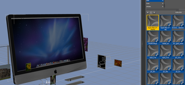

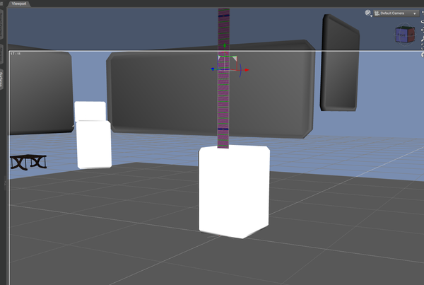

    As for the idea "Save as Scene Asset" I had to crash and restart my regular saved scene due to a render freeze. When I opened it back up, the below picture is what I got.
    That white blob in the middle with the ruler sticking out? That's the chair from the other thread, after spending hours getting the surfaces set using the "simple" geometry editor.
    The white blob in the corner is the iMac this thread is about.
    Your suggestion of "saving as a scene asset" had it switch all of the stuff in the scene to the "saved as scene asset" stuff, rather than not touching them and having them point to their original files. When (two posts above) I found that the "Save as Scene Asset" didn't do the job I needed, so I deleted those files from my computer.
    So, I've now lost many many hours of work. the iMac is still sitting in Hexagon, so maybe I can move it back, which is something..but unless there's some trick someone knows, the chair and it's surfaces is now gone.
    On the plus side, I guess I'm going to get a test of how effective the new anti-depression meds my doctor put me on work.
    1389 x 934 - 170K
  • Richard HaseltineRichard Haseltine Posts: 104,182
    The white boxes are missing geometry assets. Saving as Scene Assets shouldn't have overwritten the auto-adapted data from an existing scene - are you sure your content directory settings weren't lost? If you save a scene any auto-adapted assets go to the same DAZ Studio content directory as the scene file, if you are saving to a mapped location, or into the first DAZ Studio content directory, if you save to a location that isn't inside a content directory.
    It sounds as if you want a figure - for that you do want a single OBJ with groups, which you can then turn into a figure with the Figure Setup pane.
    Maybe it shouldn't, but it did.
    The floating geometric shapes are from a DIM installed room set. It reloads from the content folder just fine.
    I just went into the duf file with a text editor to see if I could change the paths back.

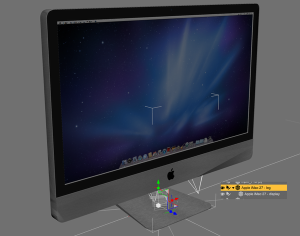

    BUT, I save the 2 imac parts in Hex, installed Hex on my windows emulator, used it's SEND TO DAZ (because that was never added to the Mac version) to get it into Daz, where I'm now at the next problem in fixing this....
    IN THE fist PICTURE are two identical objects...the upper one is the imported FBX object (with messed up surfaces -- see other topic)..the bottom is the recovered object of mine. This is in joint editor and you'll note that while their start/end points are both at 0,0,0,, the joint markers are in very different locations. (the rotation is set on the bottom to have them facing the same way.)
    The second picture shows the rotations set the same at 0,0,0, as well, and they're locations being put in the same place.
    How do I make mine (lower) match the upper. Can this be done?
  • Design Anvil - Razor42Design Anvil - Razor42 Posts: 1,239
    Export to obj - reimport - convert to figure - rig bones - save as support asset figure/ prop - done.

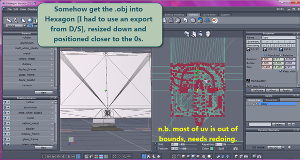

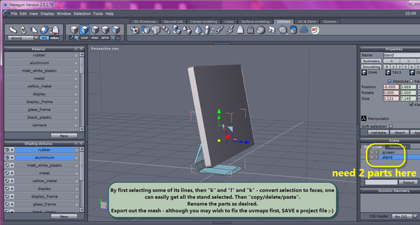

    I see no chair in the link? anyhow for starters, the .obj file crashes Hexagon.
    so, imported via D/S, exported out, that imported into Hexagon ... wowser, resized it down, repositioned it, it is only one part.
    made it 2 parts
    um, you will want to redo the uvmaps anyways ... and that then will help with your question also in another thread ... since you have the texture images, one can either make and put the uvtemplates to match the pictures OR just make some nice uvmaps then place the textures in the right place on the template using that image editor that works with layers.
    For answering this thread I am not redoing the uvmap 'cause first I would want to fix the mesh to my specifications and that's another whole ballgame.
    I'll bring this next into D/S4.8 something and see if the rigging gadget still works ;-)

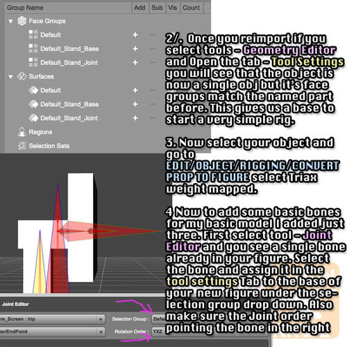

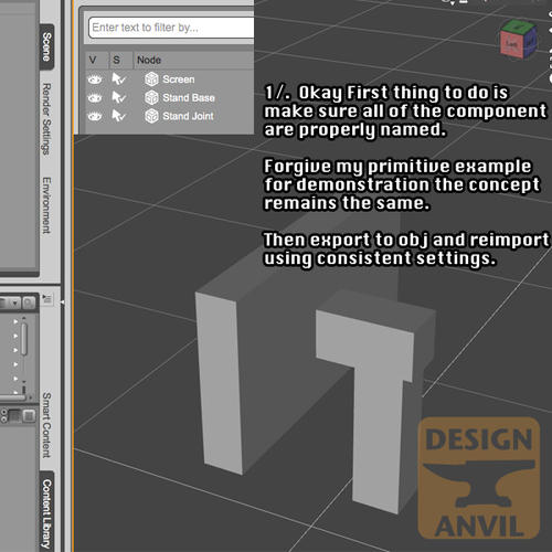

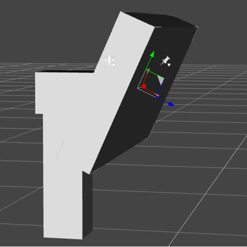

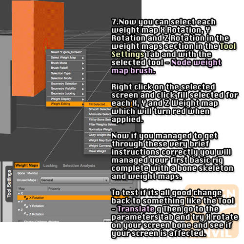

    Okay here is a very basic tut for creating a simple rig for something like a two piece monitor. Its by no means comprehensive and somewhat basic but may serve as to a basic introduction to the process let me know if anything is too vague and I will try to add more detailed info.
    Edited to fix image order see next
    Post edited by Design Anvil - Razor42 on
    Simple tut for rigging
    600 x 600 - 164K
    600 x 600 - 148K
    600 x 600 - 136K
    600 x 600 - 155K
    600 x 600 - 86K
    Second part of tut
    600 x 600 - 106K
    600 x 600 - 103K

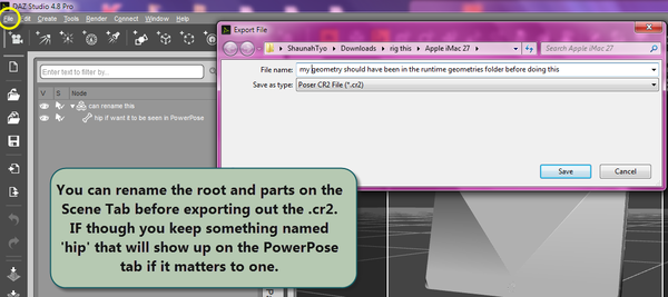

    edited June 2015
    Found a memory bug in D/S :-(
    Anyhow, in a FRESH opening of D/S import the .obj file.

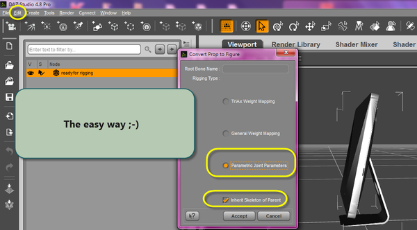

    Yes one can use the Edit geometry to convert prop to figure ... choose legacy.
    If you like it, export out the .cr2 to save it.
    Then you may or not wish to fine tune the bones using the joint editor tools and re-export the figure to save the changes.
    The bug is that if the first attempt flubs and one clears the scene and reimports the same .obj file, then the programs still thinks it is a figure and will not convert the prop to to a figure.
    edit ... oh a nice tutorial was added to the thread too, thanks :-)

    I tried the other method that was mentioned. Works quite quickly.
    1117 x 497 - 121K
    1009 x 559 - 106K
    1010 x 651 - 86K
    This chair?
    It's nice. Imported it into D/S first too and then into Hexagon. Slapped on a uvmap and fixed it a little using Shading Domains, back in D/S made it into a prop file with 2 surfaces. Thanks for the link info in the other thread :-)
    1000 x 1000 - 131K
    The model has some mesh problems...mostly some n-gons in the corners and ugly screen/glass geometry. But turning smoothing off, makes it all flat and pretty, at least at anything other than a close-up.
