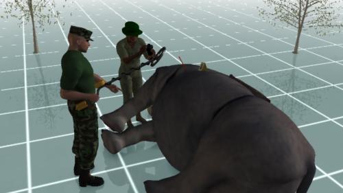

Distance fog: is it useless??
cobuspcobusp Posts: 303
Hi all. I a doing ok with my rhino poaching animation, and thanks again to everybody who gave input to my queries.

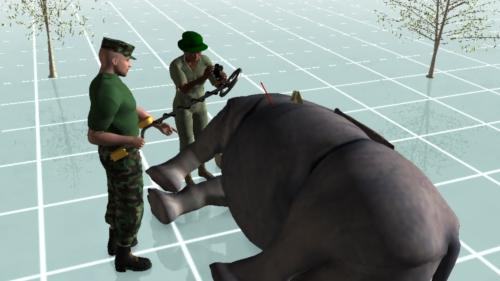

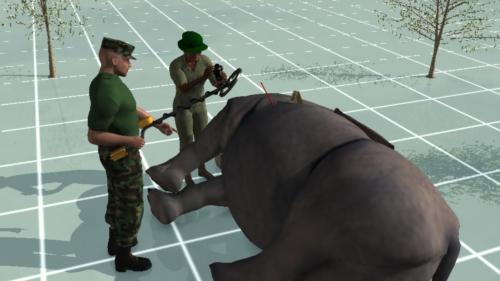

I decided to add distance fog to add depth to my scene (which looks great, compare pic 1 with pic 3). but it does strange things, and if these cannot be solved, I'll have to dump the effect all together:
If you look at pic 2, you will notice that distance fog darkens a scene considerably. Shadows become non-existent! I thought it might be the fog density that affect these, but after changing my main light to a lower angle, brightening it to 290%, and cranking up the shadows to 100%, the shadows were still missing (see pic 3). And yes, Shadows is turned on in my render settings :-)
Is here a way around is, or should I dump everything??

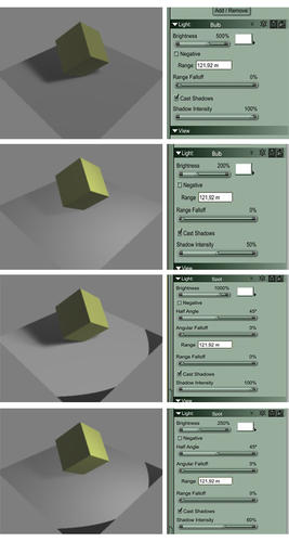

    I come back with some tests:
    It appears that the combination Distant Fog + Shadows works only with the spots and the bulbs, nothing else.
    Here some scrennshots to show that when the intensity of the shadow is decreased, one needs less light.
    Enable soft shadows is desirable to appear more natural.
    “Hope this help”, as Andy said !
    EDIT to add to push the ambiant light around 75% ?

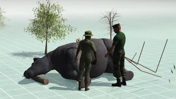

  • cobuspcobusp Posts: 303
    head wax said:
    Hi,
    Best t use a cloud instead of the fog if you want to it all in Carrara. Maybe turn off shadows for the cloud.
    you could also paint your own fog in ps, put it on a plane with a transmap texture and turn off shadows for the plane and then duplicate those planes going back into the distance away from the camera to gradually build up fog. You need to avoid the edges of the plane though in the renders as they will show up as artifacts
    Hmm .. that was exactly my next thought - thank you!
    But instead of using a cloud, I made use of the Fog primitive in the background. I changed the ground plane to an infinite plane. This, coupled with a bit of fog in the Scene parameters, I think I came pretty close to it.
    Your other idea about using trans map textures is also great! That's definitely worth remembering, thanks.
    Dudu thanks - these are valuable tests you did. I'm sure they'll be useful for other people as well! I'm gonna keep them for my reference.
    Only thing, of course, is that for an outdoors scene, one needs to use an infinite light (or sunlight), because the Sun's rays fall parallel with each other, whereas any artificial light source will project converging shadows.
    Thanks again.
