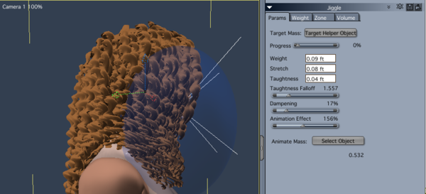

One of the production decisions I have made for my project is to use mesh hair. So I wanted to find a quick way to give the mesh hair a little life without having to keyframe a bunch of movement morphs. After running into a few dead ends I tried using Sparrowhawke3D's excellent Jiggle deformer plugin. My initial tests so far have been very promising.
The plugin give us a lot of control over most of the dynamics needed to model basic hair momentum movement. I have just started playing around with multiple jiggle deformers on the same hair mesh and so far have not run into any problems. I haven't tried but I don't believe that the weight mapping tab can be used due to the nature of the way hair meshes works. This is not a problem because the inclusion zones seem to be better suited to this use.
Below is a render of the first test I did last night. I haven't started tweaking settings yet so this is using the default values with the dampening turned down a little. There is only one jiggle deformer on this test. In the wireframe, the blue sphere is the inclusion zone and the white X is the target helper serving as the mass target. The deformer plugin is added under the hair mesh modifier tab.
