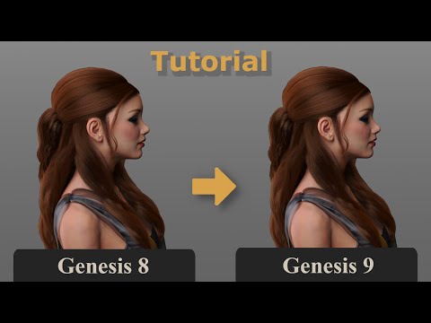

  • ToyenToyen Posts: 1,947
    Hello. I just also made a video tutorial to follow along -
  • TsubaTsuba Posts: 78
    That's very helpful, thank you !
