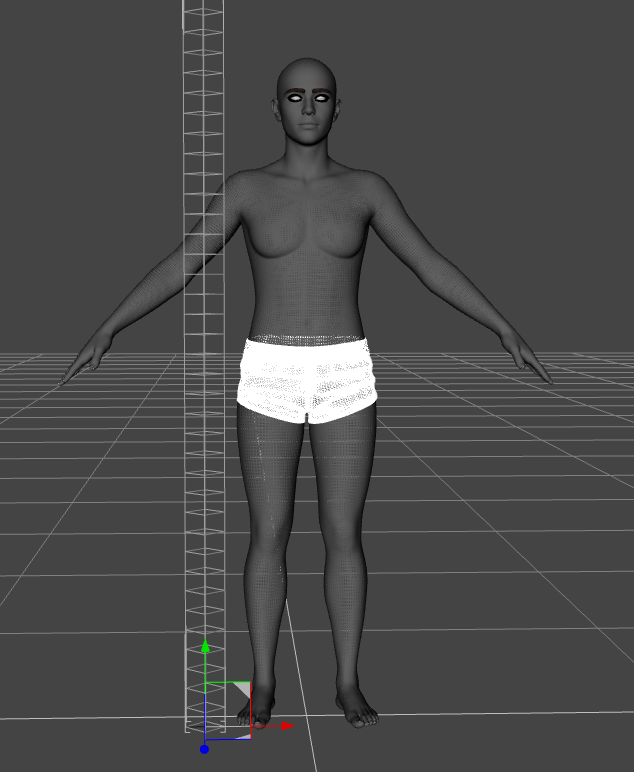

    Simplest way, create a 2m tall cylinder with 40 sections.
    Place it beside G9, set viewport to wireframe, count, from top, -5cm per step (about 2 inches for those using imperial)....
    170cm
