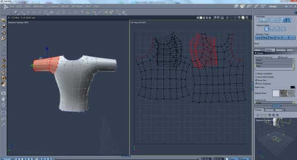

do you mean the UV islands on the grid layout ?,..
if so,. those can be selected and moved, scaled, rotated individually.
quick rough pic..

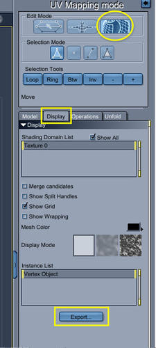

Once you've UV mapped your model in Carrara,. you can either click on the "display" tab in the modelling room, and click the "Export" button to export the Wire-frame (black and white) texture map of the mesh UV Grid ( to make a UV Template) ..see pic.
then open that in photoshop and use it as a guide to laying out your textures,.

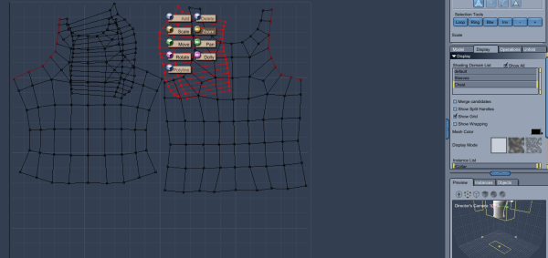

Update: No clue why but when I double click an area then click inv (invert) it lets me move stuff. I can live with one extra click of the mouse.
Could this problem be due to me using a trial version? I can't even get the right click buttons (pictured below) to work except for zoom. I also tried to unclick the show all and only show sleeves and it still would not allow me to move anything.

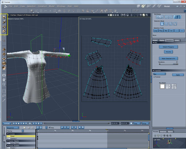

can you try creating another object, then trying to split and move the sections.
if you insert a vertex object, then in the vertex modeller, add a Cube from the top menu,. then UV map it with Box mapping. the go to the operations tab , click on one of the preset layouts at the bottom and click apply to split the box into that layout.
you should then be able to double click on any part to select it, and click drag to move it.
