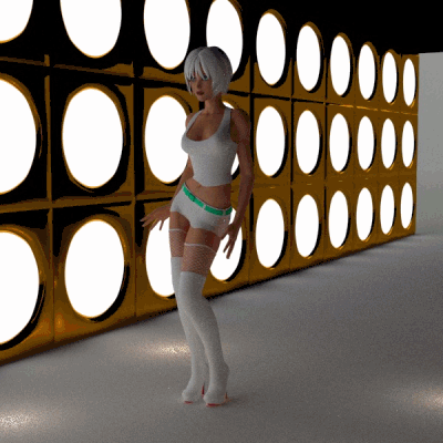

and in unrelated mews here's the animation i was rendering

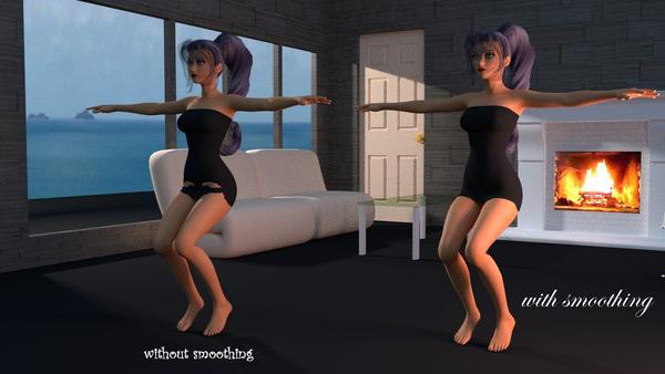

in an earlier post i was saying you could use Daz Studio's exporter to overwrite the .obj exported by mcjTeleblender

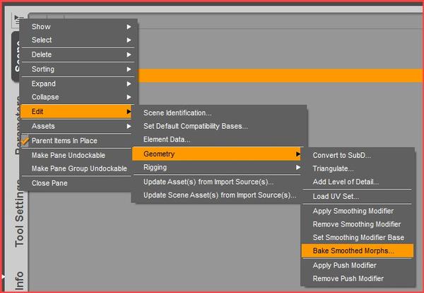

since it seems to apply the smooth modifier before the export
but the solution i use myself is to go in Scene/Edit/Geometry/Bake Smooth morphs
i will probably have to modify mcjTeleblender to make it wait a second or 2 before exporting the .obj.
Last time i exported an animation, i could see Daz Studio finish applying the smoothing modifier after the scene had started being exported ( lucky my English teachers never saw this sentence construct )

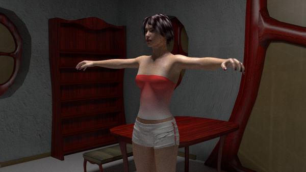

in the image shown below, the first time i exported this scene, there was a lot of poke-trough once it got to Blender,
so i baked the morphs (took a few seconds only) and this time Blender received the scene without poke-trough

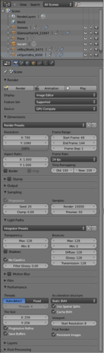

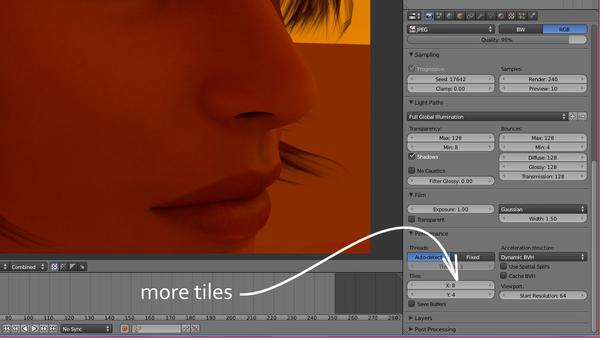

Note about Blender Cycles and Windows 7's display driver issues ( crashes )
this is not a problem with teleblender, but if Blender Cycles crashes your display driver, and/or Windows 7 itself, it seems to be related to Windows 7 time-out, if Blender Cycles hogs the display card for too long, Windows 7 panics and falls on its face.
one solution is to chop the rendering process in smaller pieces
for example if i render a 1920x1200 image with Full Global illumination and big textures, big geometry, Blender/Windows7 most likely crash
so i set Cycle's Render tiling to 8 x 4
and the render completes without harm

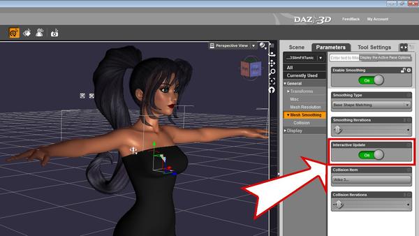

~~~ solved issue ~~~ solved issue ~~~ solved issue ~~~ solved issue ~~~ solved issue ~~~
( from a post by Wiseavatar )
when you have clothing items using Smoothing Modifiers,
they are not applied during the transfer (obj export) to Blender
the solution is to go in the clothing figure's parameters tab and
set the Smoothing Modifier's "interactive updates" property ON

i only recently went for windows 7 64-bit and had the NVIDIA driver crashing
due to (i conclude) Windows7 panicking because it sees the video driver become unresponsive
for more than x seconds during Blender-Cycles-GPU renders
so when my renders are large ( HD1080p ) or contains heavy geometry
i change blender cycles ' render tiles to 4 tiles by 4 tiles, by default, it's 1 tile
and this prevents crashes

i didn't have recent problems with blender/cycles/gpu renderings, i set tiling to 2x2
note that your version of blender seems to be more recent than mine since you specify tile sizes

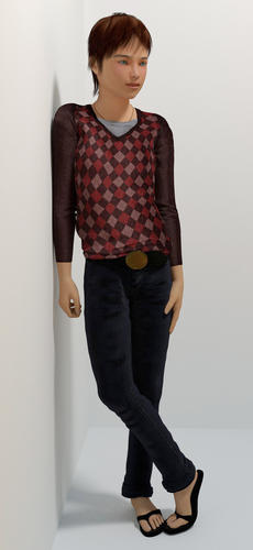

I did a little turn table animation and posted on Youtube. Only 1500 passes, so it is a bit grainy.
http://www.youtube.com/watch?v=4Ez7t8hLsz4&feature=youtu.be

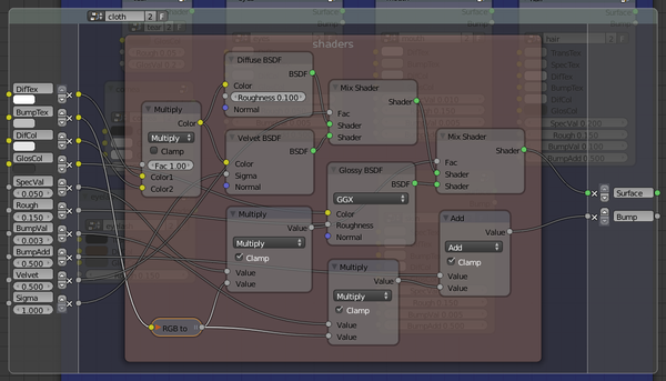

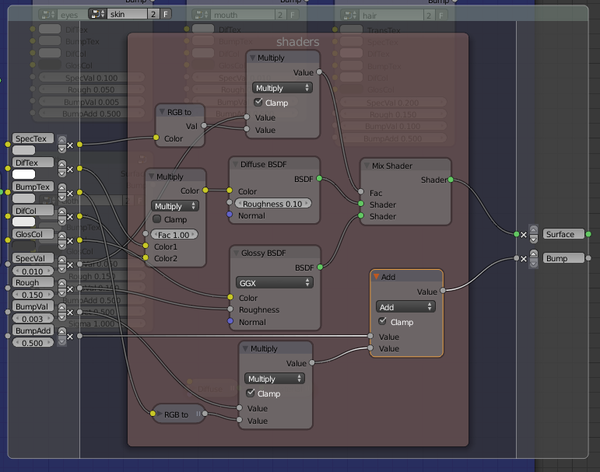

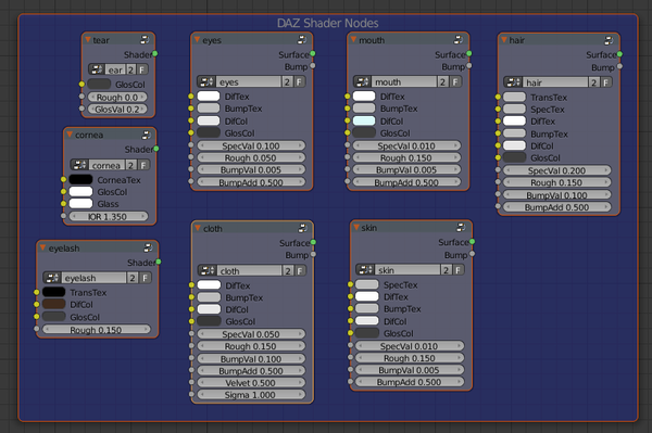

Thanks for this tool! I've been experimenting lately with Blender Cycles and learning more about using shaders and textures to achieve reasonably realistic surfaces.
However, I have some issues with the kind of nodes that this script produces for Blender. First of all, it uses an 'Add' shader node to mix diffuse and glossy, which is a bad idea in my opinion. Why not control the mix of diffuse, glossy, and transparency (when used) with 'Mix' shader nodes instead? The B&W textures get plugged into the 'factor' input to vary the mix instead of controlling the color directly.
With some experimentation I've come up with some custom node groups that I append to any file created by this script. I have node groups for skin, hair, eyes, mouth, cloth, tear, cornea, and eyelashes. I export the scene with Blender Render option checked instead of Cycles. Then I can append my custom node groups and go about assigning materials and textures for Cycles as I see fit.
The script does the important job of getting the objects, UVs, and materials all linked in the scene in Blender. I just wish it gave more options for how the nodes get set up. My method wouldn't be any good for animation, and unfortunately, I'm no coder. If anyone's interested, I can post pics of the nodes and results.
Well, I decided that I would go ahead and post some more about my shader group nodes for Blender Cycles before I forget and move on to something entirely different.
I made a separate .blend file just for these materials. I append this file into a scene that mcjTeleBlender exports to Blender. Then it is just a matter of selecting objects and materials, setting up nodes, and matching up textures. It's not an automated process by any means, so it wouldn't work for animators. But I think it gives me more flexibility and control for still shots. Perhaps some day I'll get around to learning 3Delight in DAZ Studio, but I'm really used to the Blender interface now.
The group nodes have texture inputs on the left with names like DifTex (diffuse texture), TransTex (transparency texture), etc. Below that are color (RGB/HSV) inputs that can pretty much stay as they are unless one wants to tweak a particular material for effects. Then there are value (float) inputs that can vary the roughness and amount of specularity in a material. For instance, if a piece of clothing has shiny buttons, I can decrease the roughness setting and/or increase the specularity. I might even change the specular color to something more 'metallic'.
A skin node group can be assigned to one material of the torso, limbs, or face. The textures for each area can then be added. Then the material can be copied and pasted to other materials that use the same texture set. For example, set up the material for the nostril, and then copy and paste that same material to the skin-face and lips. Put a skin node group on a part of the torso, apply the textures, and copy/paste to all corresponding torso materials. The only thing that actually needs to be done inside the node editor window is to manually connect the node group 'bump' output to the material displacement socket. The rest can be handled in the properties window.
Here is Justin/Aaron as an example of the node groups I described above.
Skin shader node group. There isn't a standard SSS shader for Cycles yet, and I haven't found a 'cheat' that I really like.

So much to learn and do and so little time!!
My current 'cloth' shader node group:
