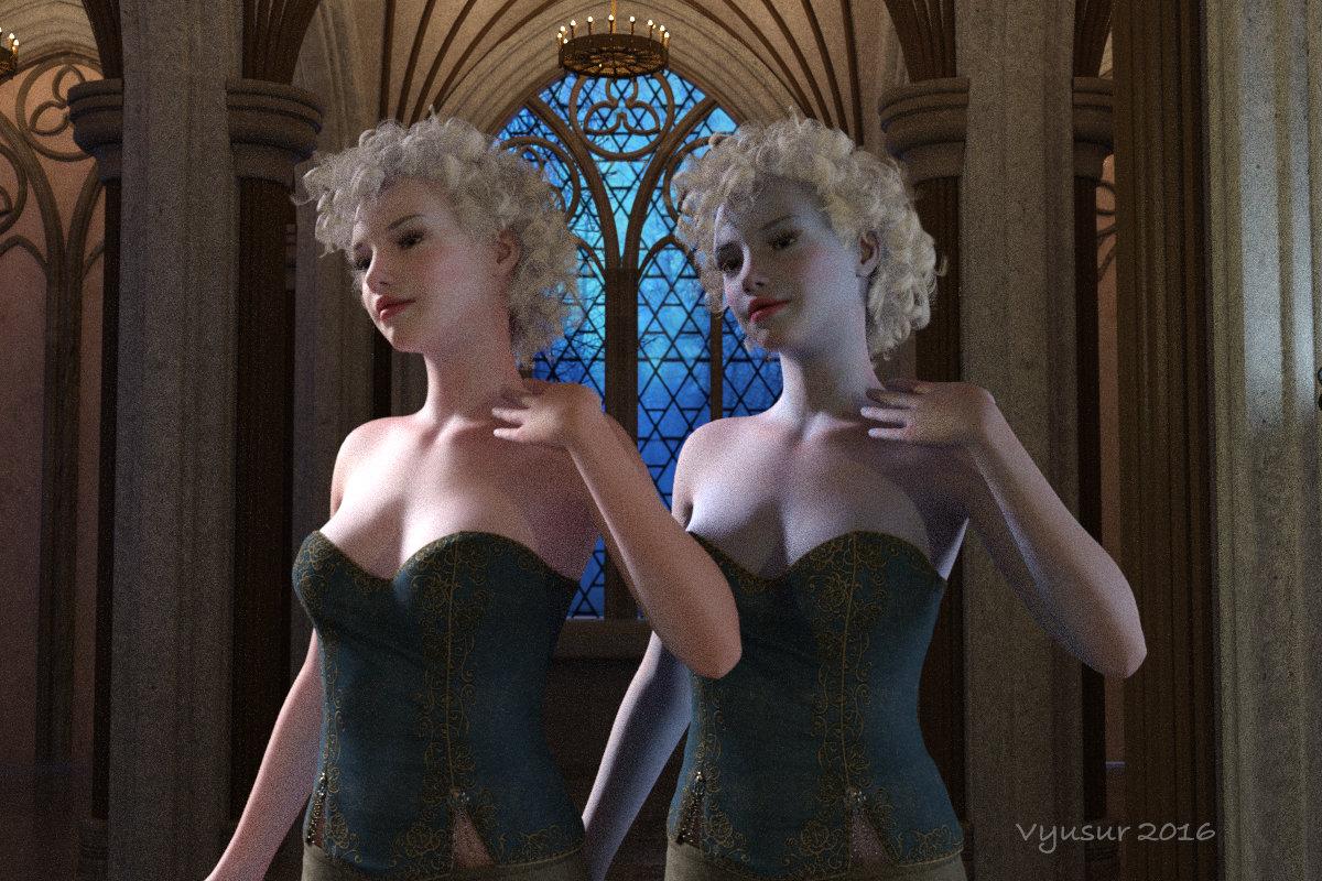

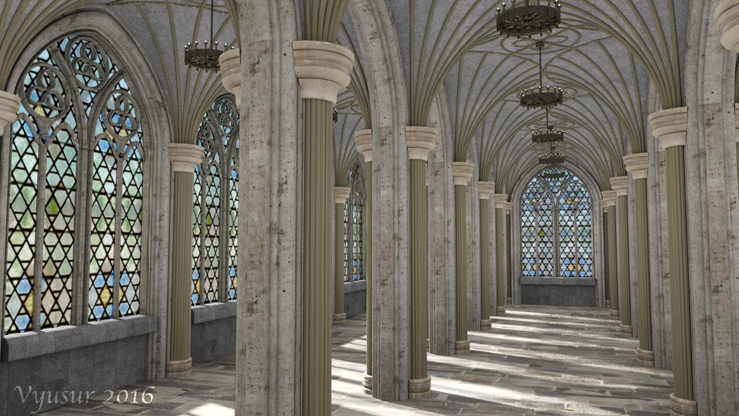

I've modeled this arch gallery in Blender in the end of 2016. The first picture is rendered with internal blender render engine, the second one – with Daz Iray. Here I've tried my new arch environment with people and night lighting.
Vyusur, you are a crazy good modeler, I'm very impressed by your work!
Congratulations!
Dudu, thank you so much! I'm very glad that you like it.
Beautiful work, Vyusur!
TabascoJack, thank you very much!
Arches and vaulted ceilings - what fun! Nice job.
TangoAlpha, thank you! Glad that you like it.
Nicely done... looks very good indeed!
