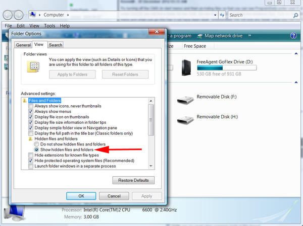

  • SzarkSzark Posts: 10,634
    Computer education time.....You need to go to the Windows Folder Options...easiest way to get there is open Windows Explorer > Tools > Folder Options (see image below)
    As for what to do next see this thread http://www.daz3d.com/forums/discussion/8028/#105548

  • wancowwancow Posts: 2,708
    Okay... wow, According to cridgit this is where I should see the files:
    C:\Program Files\DAZ 3D\Content Management Services\databases
    Now, that might be a hidden folder, but I can't figure out where the tools are to see hidden files and folders in Windows Explorer...
    I'm using Windows 7, and there is no tools pulldown :(
  • MKeyesMKeyes Posts: 472
    It's right above in the row of menus across the top of that area.
    However, I've done that... I can't find the databases - and I've gone to the other link above, but as I'm looking at it, I'm not certain where to delete the databases since I can't find it.
