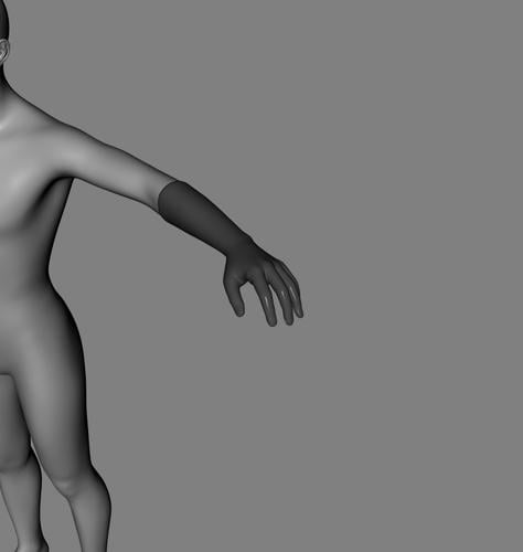

V4 Glove Clothing distort/streching on Genesis with Autofit
So, I've got Y-Stylez's Katey for V4. In particular I'm working with the Witchy Hands clothing/accessory. Autofit seems to convert the glove over pretty well until I create any type of movement that changes the hand location.
As soon as the spatial position of the hand changes I get distortion and stretching in the fingertips of the glove. This distortion looks exactly like the genesis stretching issue with some V4 poses due to xyz translation - except it's on the clothing piece (http://forumarchive.daz3d.com/viewtopic.php?t=170864).
Anybody encountered an issue like this with similar clothing? Or more hopeful: anybody have a fix?
Screenshot attached.

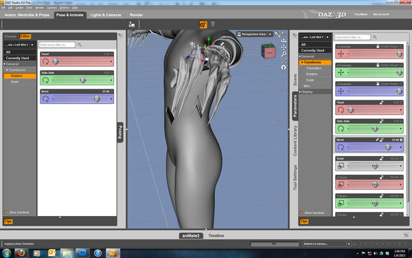

  • matt_e8d6faf681matt_e8d6faf681 Posts: 0
    Ahh, found them (hidden parameters).
    No, as far as I can tell, weight and all the other hidden ones have absolutely no visible effect.
    1680 x 1050 - 351K

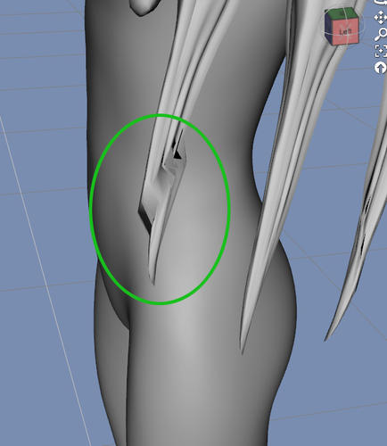

    Seems it's takes quite a while to update. It did change the effect but I think the streching is still a major issue - have to look at it a bit.
    So it does indeed have an effect. The mesh is being smoothed out to not look as distorted. Unfortunately - I think Richard's analysis of the situation is correct - the tips aren't moving with the finger joint actions (they do move with ARM translation). So the result is a bizarre tear in the mesh - which smooth can make look less severe but I'm not sure it can correct it.
    After looking over the rigging tutorials I may be in over my head but not ready to throw in the towel yet. :)
    1680 x 1050 - 322K
    Of course as I said that the last setting one proved me wrong...
    It looks like it can correct the streching some - but not enough with my current settings. Any suggestions on other param configs I should try?
    1680 x 1050 - 310K

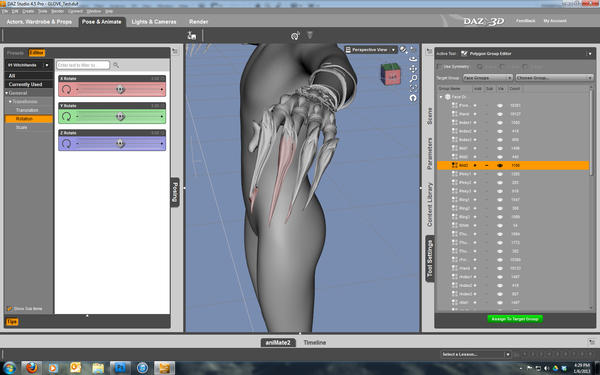

    Ok, Richard. Got some pretty good progress. First - This is not a freebie figure.
    I read your armor tutorial and found it extremely helpful. It allowed me to find the exact problem AutoFit is introducing. I looked at the Face Groups on both an autofitted and non-autofitted target. The issue is not that the tips are being left off but that they are being mis-assigned. They attached screen shot I believe shows the problem pretty well.
    So, after some reading of your tutorial and working with the Group Editor and Weight Brush I was able to get the polygons on the tips assigned correctly. And indeed - they now move as one object independent of the other fingers. My remaining issue is in the initial stretch damage caused by the first AutoFit import. Shown below and circled in green is the state of the glove after the first import without any movement. Fixing the Face Placement and Weight Map doesn't correct this issue but does allow for further stretch damage to be avoided.
    I tried using the Transfer Utility to see if I could get it imported without being fit and unfortunately that didn't help.
    Any suggestions? I really appreciate the help so far!
    1680 x 1050 - 322K

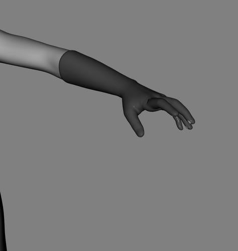

    And the initial stretch problem:
    626 x 722 - 75K

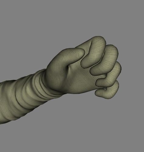

    Well, that seemed to work out. It was difficult to re-align them but the end result looks pretty good.
    For anyone following in my footsteps - I recommend using the POINT selection tools in Hexagon and then use the simple axis translation tool to move the mis-aligned points.
    After I got the Morph back into DAZ I saw it wasn't perfect - but a Smoothing Adjustment with 5 iterations (both smooth and collision) took care of all the imperfections I was unable to correct in Hexagon during the re-alignment.
    Also - the re-rigging just seemed complicated. It really wasn't so bad. I HIGHLY recommend Richard's tutorial thread.
    Thanks again everyone for all the help. Here's the results:
    1139 x 644 - 74K
    I was thinking it was probably any issue with the odd "claws". The polygon mis-align was as follows:
    Thumb: OK
    Index: Tips downshifted by a fair margin and mapped to Middle
    Middle: OK
    Ring: Tips mapped to Middle
    Pinky: Tips mapped to Ring
    It was easy to see all the mistakes in the Weight Map and the Group Editor.
