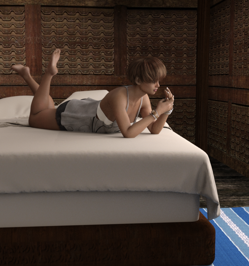

Should these ghost lights cover just the window glass, or should they be expanded to cover the entire wall, from floor to ceiling?
Personal preference, I usually have it 3/4 or half the size of the wall if I am trying to light an entire room. And you can see by just changing the intensity of a light, you get a different look very easily. I had one at the headboard, vertical and slightly tilted, for lighting the bed behind her (aka the pillow section).
Then one on OUR left, middle of scene- the light is about half the size of the bed and very dim (that's the one I played with and will give you that change of lighting between the two renders.)
Third, the window one- it is 3/4 the size of the wall but not near the floor so there's no "wash out." That would be our right side. It is inside the room, not outside the window. Also watch out for your corners of the room, I try to stay several "feet" away from those if I only want to cast light in one direction.
If it's supposed to be a diffuse light coming through something specific like a window, the aperature created by the ghost light will generally look best if it's approximately the same size and shape as the window. There are exceptions to every rule, of course, one being to use multiple ghost lights outside a single window to simulate light coming in from multiple different directions outside. I just did a big scene set in a big room where one entire wall of a penthouse was a single massive array of windows while the external light coming in was a mix of the HDR and light in the windows in outside buildings streaming in, all of which were at different relative positions to each other. Since I acheived the lighting in the other buildings almost entirely by using emitters with images of the inside of the buildings on the emmit plane, I knew they weren't really going to be bright enough to cast enough light to look correct without completely blasting out the interior images, so I bulked out the effect by putting ghost lights at angles appropriate to the direction that those windows would have been streaming outside and at angles streaming in. The nice thing about doing it that way was that I could adjust the light inside the buildings and the light the buildings were casting completely separately.
I'm not seeing any differences, or maybe I'd recall the update. Anyway, I used ghost lights in a render I did for the Hidden Treasures- Fun with Older Sets thread in the Art Studio forum. The only lighting inside the set is a ghost light for each window, placed just inside. The windows are emissive to simulate light coming through, but they are not transparent. The only other lighting is the default HDRI, which doesn't reach into the back of the set. This is...
BRC - Serenity
@ladair That's very pretty- it's tranquil. Just the perfect amount of light. The details on those windows are crisp and really make it look three dimensional, I feel like I could walk in and actually be there.
Thank you. It really helps that these small older sets have a lot of detail modeled in, instead of relying on the texture to produce the shadows. I did a "clay" render from another angle that really shows off the work. (Below)

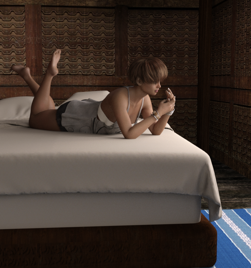

As the others say, it's really up to you and what you are trying to accomplish. In the render I did of Serenity, I was trying to get as good a look as possible for the set with as little work as possible. The only way for light to come into that room is from the big opening on one end of the set or the three windows on the other. I probably could have used one larger Ghost Light in the ceiling, but bringing the light into the room from the direction of the windows is more realistic. A bunch of us are showcasing pre-Iray sets in Iray, so the idea is to do something simple that anyone can achieve. If I were doing a scene with the set, I'd put a lot more work into those windows, so they would be more transparent and the gold caming would look metallic. And I'd still use ghost lights, because they are by far the best way to simulate ambient light in Iray.
I did a "clay" render of the set, too. For that render, I used a ghost light approximately the size of the long way, inside and next to the wall facing away from the camera. All I needed was to illuminate the interior to show off the modeled in features:
With the "hallway" lit, you can see how dark the back end of the set is. It's essentially a short tunnel with a dead-end.
I was just playing with another old set, and it has a bunch of windows with transparency. I put one huge Ghost Light inside, with a warm temperature and immediately, all the windows glowed. Or I could have used one small ghost light at some of the windows, just inside, and left some of the windows dark. They are very versatile.
Just have fun, be creative, and keep what you like.

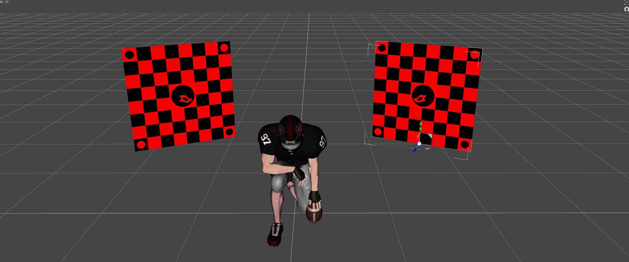

can i use these ghost lights, to put BEHIND a character, to make it look like she was standing in front of a fire or explosion? Like, have an orange-y light behind her and it kinda lights the back of her. I'm pretty sure it CAN be done...but I'm trying to figure out the correct brightness/colour to do it. any thoughts/advice?
Hey Blue! I think what you're trying to achieve is more akin to rim lighting? Well, kind of a hybrid between rim/back lighting. Either way, i would use two lights instead of one light. I'll post a render below with just two ghost lights and a very low emission HDRI. The two ghost lights are at the back with an emission value of 2000k. Is this what you were going for?
Yes! I had a brain fart - rim lighting was what i was thinking So if I wanted the 'orange' to be brighter, I'd go for a higher emission? And with your ghost lights, would I add the colour myself, or would you suggest one of the presets in there?

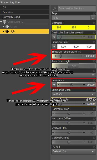

Emission temperature controls color (unless you actually use the color picker, but that's for noobs and people who like neon). A lower emission temperature will produce a more red/orange tint (around 1000k-2500k). Luminance is intensity, higher numbers produce stronger light. Remember to keep any fill lights or HDRI's quite low, to keep the front of the character quite dark. The effect you're going for won't work very well if the character is fully lit from all angles. So, low key HDRI, 2x ghost lights, 2000k temperature and 900kcdm2+ for the luminance. Here's another image to help....

Yeah, Ghost lights are really neat. :)
