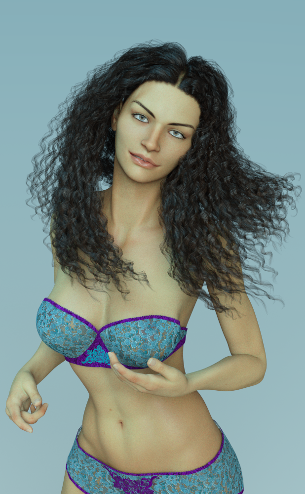

    Here is a small render of Bellina to :)
    651 x 846 - 88K
    618 x 1000 - 854K
