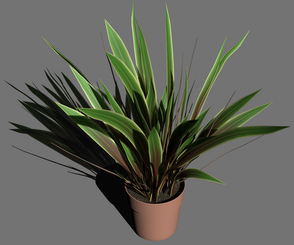

I have been working on a model of a plant leaf type, custom built for Bryce so that I may learn more about creating materials and the way, once the models are imported appear.
Was really trying to keep a happy medium between low poly and smooth curves.
This one was built in Hexagon, the initial idea is to create a model of a New Zealand Flax plant although so far it has turned into an experiment more so with the material, the Flax plant leafs are much more straight, well the leafs on the plant I have outside my little flat in London are..(and the material is not right..yet!)
One of the requirements of the material is to give an edge colour to the leaf, I must say though I do not wish to use an image texture, although it seems the only way to get what is needed is to make sure the model is uv mapped and then in Bryce use parametric mapping, in this case the the leaf model was made with a flat grid that was planer uv mapped before any alterations to it, a technique I believe some use to model hair for characters for Daz Studio.
Also to get the yellow edges was a subtle combination of x scale which turned out to be X 96.5% and 1D noise 126 I wonder why X 100% is too much?
I would be grateful of any comments,feedback and ideas as to improving please.
Here it is for download.
Download Flax Plant test.zip

  • Rashad CarterRashad Carter Posts: 1,807
    You can make the leaves translucent, even with a UV map, but it requires that you create a mask. Make the mask so that the parts you want light to penetrate need to be black, while the parts of the map you want to remain solid need to be made white.
    Before we go any further I want to make it clear the difference between transparency and translucency. The two effects are very similar except that standard transparency engages internal reflection, making the leaves look like glass instead of looking like a living thing. So the trick is to make the item transparent while not making it reflective. Here are two links to some materials I made for Bryce long ago that explain how this works. You need to create an account at Bryce5.com. There are two examples, one made with a bryce leaf the other made with a uv mapped clematis flower.
    When you get the texture home and open it up you will notice the clever means used to enable translucency without introducing any reflection. You will notice that the item has translucency but the transparency slider is at 0. You will notice a procedural named "Black Nothing" which is used to create the magic of the effect. In the case where you have a uv mapped plant where you want only the leaves to be translucent but not the stems and trunk, you will need to apply a custom made map to the transparency channel replacing the procedural I used. A black image works just as well as the Nothing procedural. You will also notice that the transparent color channel and the volume color channel control the degree of translucency and can even tint the "shadows" created by this object.
    I know it seems like Spanish but when you see the material in the material lab it will make sense. Keep in mind, you will not need to use any ambient glow since the leaves are already receiving light in a natural way. Render times however, are longer, much longer, so be prepared. Best of luck

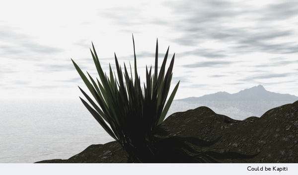

  • TapiocaTundraTapiocaTundra Posts: 268
    Thank you for the comments
    @Horo I am not sure about the uv maps now you say that I cant make it translucent, the only reason for the uv is that the parametric material will not work otherwise, I am not using an image,I will have to find out more.
    @Kiwi-gg some great reference pics and I love the Tui bird it's beak is the same angle as the flax flowers,how lovely. Those flowers look tricky to model but I'll have a go.
    @Oroboros I am getting a little confused now. Why would 7 have problems with a uv map? I cant get the material to work any other way as parametric mapping works on all the separate objects.
    @ Rashad Carter thank you, I shall do as you advise, looks like I better get started then, dos cervezas por favor.
    I have enjoyed making this New Zealand flax plant, it is more what I had in mind, any feedback welcome as I would like to try to model some more plants so comments do help so test it out and please let me know what you think.
    I really want to get to grips with the deep texture editor it is becoming less irritating but time consuming.
    Phormium_Sundowner.7zip

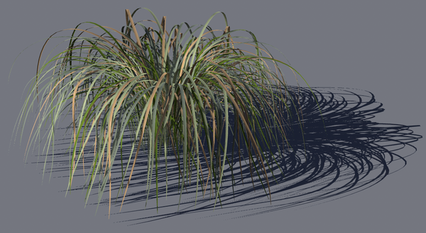

    As you can see, I have been busy, this is the first idea for the New Zealand Toetoe, the leaf blade stems anyway, there is a fair bit of work to do yet :) do not know how to start on the flower or panicle, the plant obviously changes throughout the seasons ,have seen some images with a tighter floppy look rather than candy floss that may be easier to model, it would help of course if I could look at a real one, I have not been to Kew Gardens The Royal Botanic Gardens, Kew for a couple of years, maybe go for a visit.
    Aiming to produce an Austroderia toetoe, there are 5 species of Native tall grasses in New Zealand.

  • bighbigh Posts: 8,147
    good start
    now about 5 to 10 stems reed looking in center with the flowers ( kind of like cotton candy ) on top
