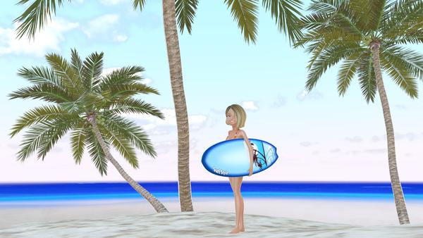

My attempt using Blender Cycles to emulate the above based on light and view dependent shading nodes...
