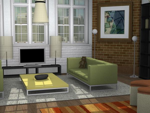

I'm currently stuck with a lighting / shading problem with imported props. The items look perfectly fine in active viewport when editing the scene and also look fine when rendering with normal lights (raytracing on or off).
Howwever, once I use UberEnvironment with Ambient Occlusion effect, the whole figure is blackened with only it's edges (wireframe) showing some light (see attached images).
The item is using the standard DAZ shader. I've tweaked every possible setting in the material, but it doesn't change anything.
Now my assumption is, that the AO shader does not know how to correctly shade my object. The question is, what editing steps are necessary to make the Mesh / Texture / Material work with AO? I hope someone can shed some light on this. (Pun intended ;)
Here are example images, with and without AO shader.

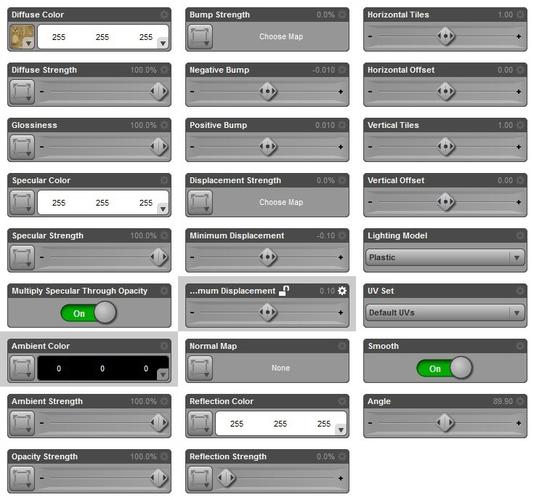

Can you post a screeshot of the surfaces for the ted otherwise we will just be guessing. Also it looks like the ted is low poly and may need Subdividing so you could try using the Sub-D function which you will find under Edit > Geomtery : Convert to Sub-D (or something like that as I am rendering and cannot check)

I have made screenshots of the ted's materials, though I'm not sure it's helpful. I pretty much left everything at it's default. I have also experimented with these settings for two full days now and it didn't fix anything. I also copied the mat from the sofa onto the ted and just set the texture back to that of the teddy, just to be sure. As you can see, the sofa is fine in UE2 render, the teddy is not. The only thing that will make the ted light up is ambient color and strength of course. But that isn't really a solution.

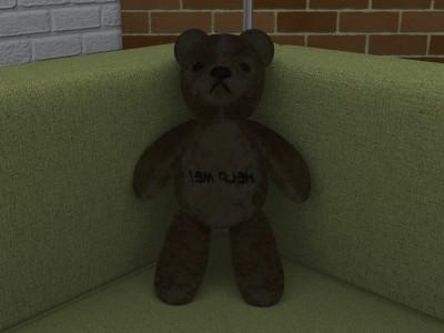

I have also thought about what jestmart said about normals. Actually there was a normal map that came with the OBJ, but using it or not makes no difference, so I finally decided to not use it. However, I noticed something odd - which I show in my second attached imaged. It seems like the texture is mapped onto the mesh mirrored. I wrote some text onto the texture to demonstrate. According to what I know so far, writing onto textures (to make signs and such) should work - as in, you wouldn't be required to H-flip the text.
Also, I set UE2 intensity + occlusion strength to 75% this time, so you can see the black text. Notice how the figure is not as black as in the old image. It seems as if it somehow drops shadow on itself.
So all this brought me to thinking that maybe there actually is a problem with normals, making the texture pointing inside the figure and thus causing the figure to be entirely shadowed. Could that be it? If so, then how can i fix this?

No the scene is fine, it's Appartment 39 from DAZ and renders just fine with AO, as can be seen in the attached image. There are no ambient colors except for the TV picture texture, when used.

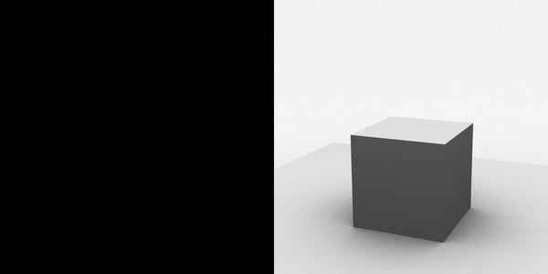

An imported object with normals pointed inward will render black on the outside when using UE2...
The attached pic shows this... rendered using UE2 only... imported cube object with a texture map applied to a white diffuse channel
One cube has the normals pointed out, one the normals pointed in and one has the normals pointed both ways in a checkered pattern to show the effect on a single object...
As for the teddy bear... I think what may have happened is that the original object had the scale inverted before it was exported or during export... thus flipping the normals and reversing the UVs.... You can try importing it into a modeler and inverting the scale and then check the normals to see if they are then pointed out, then re-export the object... that should fix the reversed UVs also...

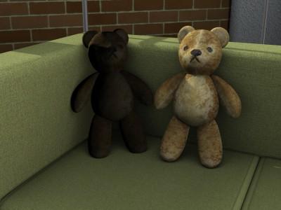

Anyway, thanks Nicci for your answer and your assessment was correct. As I found out in the meantime, the object just needed its normals inverted. I did this in an external modeling program and now the teddy is finally out of the shadows. :D
Just in case anyone finds this who has the same problem: If the object gets completely saturated in shadow, its probably because the faces "point" inward into the figure due to a conversion bug.
Just load the object in a modeling program and use "reverse normals" or a similarly named function ("Invert" in Wings3D).
