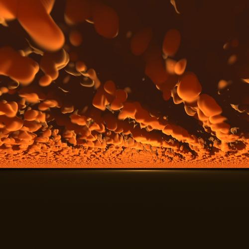

    Bellow there is attempt barely visible (with ~290 metaballs grouped 2 by 2 ) to get such clouds from metaballs without a great succes, tho on the right side i got BY CHANCE a very close effect.Might be the result of the texture ,rotated randomly.I worked only with dust and atmosphere glow from Atmospherics , the dust doesn't goes very well but the modified atmosphere glow seems much interesting in the end.To bad i modified the sun power from 100 to 400 and still nothing, i placed even a powerful light on top of the slab and still nothing .If i increase transparency, that poorly mammatus effect vanishes .
    So i will model/sculpt later these pouches on an obj mesh and hopefully find a cool material combination to apply.A mesh will block completely the sun from above ..

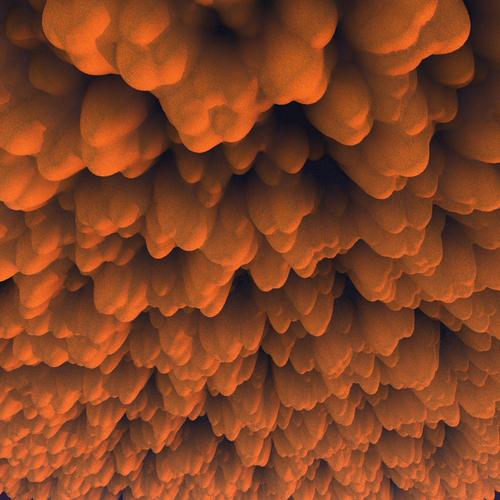

    OK had a little go at this using a DTE approach. If you want the source file to play with, just email me and I will post it back to you.
    mail@davidbrinnen.com

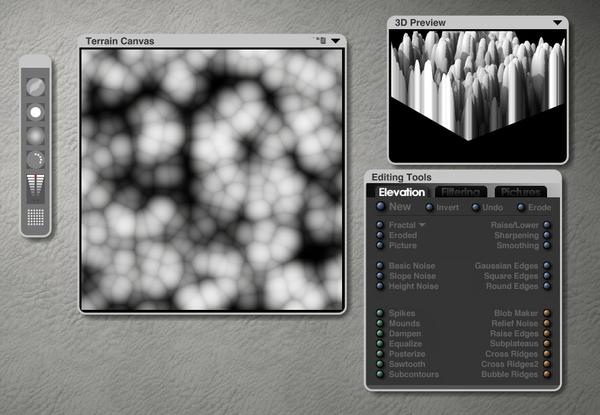

    Using a combination of Voroni dist squared and waves functions. My advice, if you try this, don't render to the horizon, cover it up, the AA pass there is very slow.
    Edit. Alternatively, you could use the Terrain Lab as a modeler driven by the DTE, as shown in numerous tutorials, indeed I think I did one recently along these lines. Bryce 7.1 Pro Advanced - using the DTE as a geometry synthesis tool - by David Brinnen
    Make your terrain and export as a mesh at whatever resolution you need. If a mesh is what you are after.

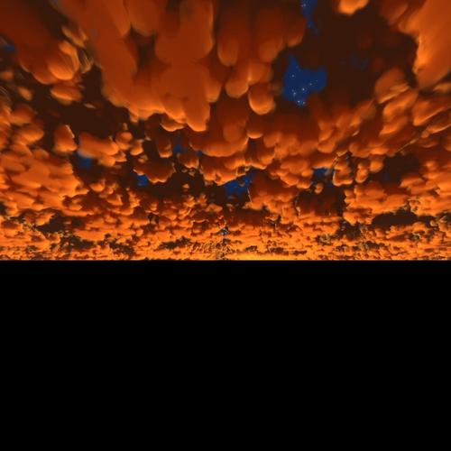

    The thing that slows down the volumetric rendering is the depth of cloud you are looking through. And remember Bryce world is flat. So this is a particular problem. The infinite slab, if you look straight up is as thick as it is, but looking towards the horizon, your view is slicing through that slab at a low angle, almost to the point where from the cameras perspective, you are looking through almost infinite thickness. So some mountains on the horizon are very welcome to stop this happening. Haze won't help you here, it's not solid.
    The material could be adjusted to make it more like the clouds in the photo's, it might take a while, but it could be done. The overhead might be longer render times. It all depends on how much the clouds are the focus of the scene as to how much time you consider worth investing in them.
    Edit. Changed the distribution a bit.

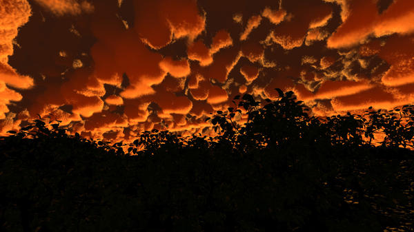

    You can delete the 1st part because i changed the scene, added some stuff , removed 2nd terrain and changed the first terrain with one more simple ,resized the first in terrain editor to 512 ( i hope Bryce does really apply the changing to 512 from 1024 ) .
    Now the .br7 scene is 9.1 mb from 12 mb.
    (mailing now the 2nd scene in 1 .br7 file)
    I uploaded the first scene Oddclouds1wild_m.br7 on sharecg named :
    Odd (mammatus) clouds for Bryce by David Brinnen
    http://www.sharecg.com/v/71262/view/5/3D-Model/Odd-mammatus-clouds-for-Bryce-by-David-Brinnen

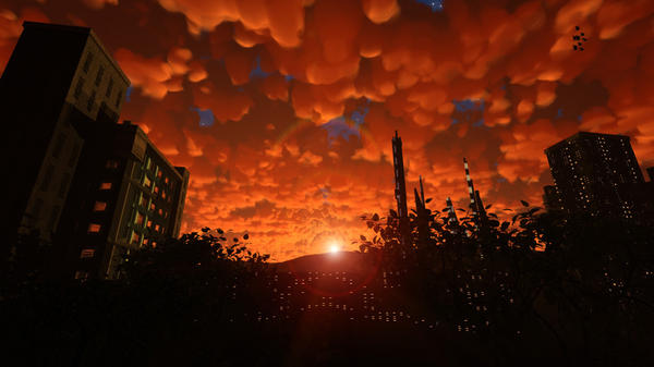

    Project finished :).Special thanks to David Brinnen , Sean Riesch and to the webdesignerlab for the free (to redistribute with credits) birds brushes (included on the scene upload).
    Minor postwork (birds and sun flares) in photoshop for the final image.
    I uploaded the second scene,the urban version Oddclouds2urban_m.br7 on sharecg named :
    Odd (mammatus) clouds 2 for Bryce by David Brinnen
    http://www.sharecg.com/v/71320/view/5/3D-Model/Odd-mammatus-clouds-2-for-Bryce-by-David-Brinnen
