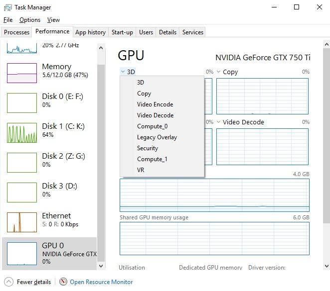

  • fablemanfableman Posts: 23
    I found how to make the task manager to show the correct GPU load.
    Select Cuda instead of 3D in the graphs.
  • NorthOf45NorthOf45 Posts: 5,586
    There's a graph for CUDA in Task Manager? Must be a new version, or the NVIDIA driver provides it. Still reluctant to update the driver from 417.71...
    The 3D graph should show activity while you move the viewport around.
  • Richard HaseltineRichard Haseltine Posts: 104,182
    I'm using the current (419.3something) driver and don't have a CUDA option for the graphs.
    Things that make you go Hm-m-m...
    So, fableman, is it rendering okay or not? Your comments only say you can now see GPU activity, but does it still render very slowly, or what?

  • kenshaw011267kenshaw011267 Posts: 3,805
    Win 10 pro and the 419.35 driver and I have it. Look at the bottom of the menu. No idea when it showed up.
    edited March 2019
    Latest driver, Windows 10 up-to-date as far as I can see:
    662 x 585 - 88K
