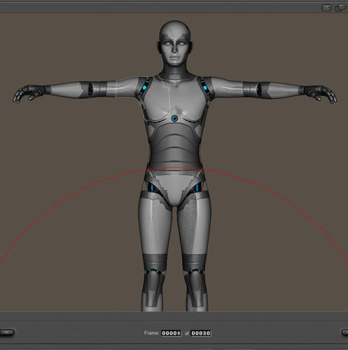

    Ok. Well, this may not be very helpful at first but bare with me. The image below shows what I get in PP2012 and you should be seeing in the Poser preview window. Notice how the joint areas are fully transparent except for a black outline? Anyway, I think it is either like you said, a ghost geometry or geo-grafting not working or something. The problem looks like it is specific to the new version of Poser. What makes things worse at the moment is that I don't have PP2014, so it adds another level of complication to troubleshooting.
    Let's try to start on more even ground and then I'll see what I can do about getting into the same version as you. Can you try loading Genesis without applying any morphs or other settings and then loading Bot Genesis? Then bend an arm or a leg or something and show me a preview and let's see if conforming is even working.

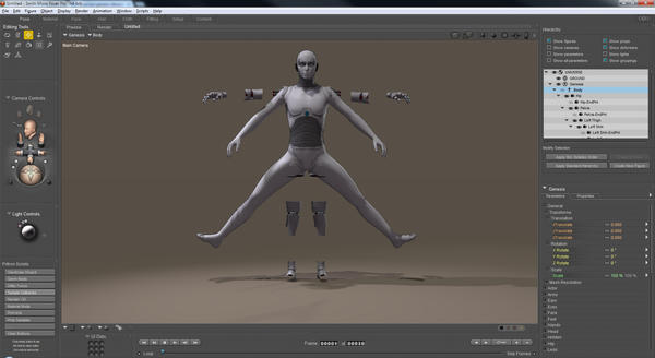

    Here's my screen, and these are the steps I did on this load:
    - Double click Genesis to load her in.
    - Drag/drop Bot Gen All to load/conform.
    - Turn SubD off.
    I did notice something wonky that I didn't notice before. While the bot_gen_torso and head are conformed to Genesis, everything else get conformed to other things. For instance bot_gen_lhand, is conformed to bot_gen_lankle, and bot_gen_lelbow is conformed to bot_gen_head, etc.
    /edit
    Progress... somehow. No phantom Genesis, but still not conforming. lol
    1920 x 1050 - 666K
    1920 x 1050 - 637K
    Post edited by Lissa_xyz on
    edited January 2014
    It's loading all parts at once that's breaking it.
    I don't know why I didn't think of this much sooner, but using BotGen_All, or loading all of the individuals at the same time breaks it. Loading them 1 by 1 works perfectly. Tedious, but works.

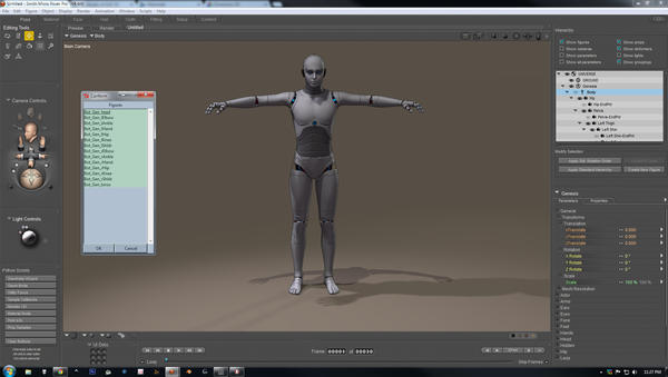

    I just found an extremely simple workaround for this. D3D has a free script that still works in PP2014 to conform multiple items at once.
    Load Genesis
    Load Bot All
    Select Genesis > Body in the scene
    Run D3D's conform script on all bot parts and voila!
    The script is old, so at first it doesn't look like it'll do anything, but once you try moving the camera or something it starts working.
    Link to the script: http://d3d.sesseler.de/index.php?software=poserpython&product=conform_figures
    1914 x 1080 - 711K

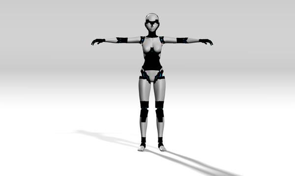

    Well, after you said that I decided to test 1 more thing. I opened DS and created another set of PoserCF. They work perfectly and auto-conform properly, including the Bot All. It loads in looking like a black/neon blue Tron suit, but it works. :D
    Doubt it matters, but I created them using the latest beta of DS (I rarely use the release version these days). I also have importer version 1.1.2.66 installed on Poser's end.
    Here it is tested on Tsukiko for A5.
    1396 x 832 - 73K
